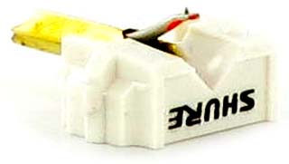

steve_1979 said:It's all sorted now. I've sent the ebay seller (Iconic Audio) a photo and he's posting out a new stylus on Monday. Iconic Audio does seem to be a good seller and if anyone else is looking for a Technics then I recommend having a look at his eBay shop. There was no quibble on getting a new stylus sent out and his communication has been good.

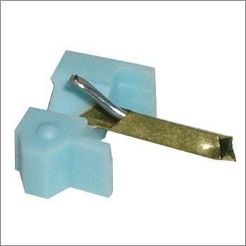

Vladimir said:Take out the one you got, set it on its back and adjust it so it's straight. It should work fine.
steve_1979 said:Vladimir said:Take out the one you got, set it on its back and adjust it so it's straight. It should work fine.
I was tempted to just bend it back but I haven't got a clue what I'm doing and would be worried about it wearing out the records if it wasn't right.
With the Shure M44-7 cartridge it has a replaceable stylus so it's not a big deal or too expensive. Even though the cart was £50 a new stylus is only £18. They do a few different ones too so if I want a different sound it's easy and cheap to do a quick swap between the different shaped stylus.

Myth: A cartridge is permanently damaged and should be replaced if the stylus appears even slightly bent
Cartridges and styli are hand-built and always have some finite tolerance in their construction. No stylus has a cantilever that is perfectly straight.
That said, a severely bent stylus can cause azimuth and alignment errors which may be audible. In extreme cases, it can cause record damage. However, the cartridge itself is unlikely to be at fault; only the stylus would need to be replaced.
In the case of Moving Coil this is not correct. The stylus is part of the unit and the cantilever/stylus assembly cannot be removed. Stylus can be re-tipped but not just simply replaced like a moving magnet. Its often more costly to re-tip than to replace. There are cartridges that are indeed perfect (straight) in manufacture using elements that stay straight yet can flex in service.
