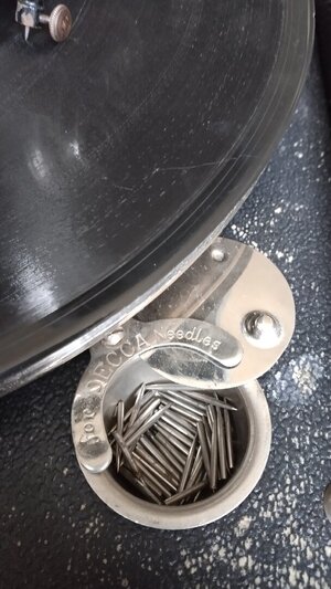

Older Mono records have a U type Groove Mono/78RPM 3.0mil is the accepted norm & Steel Needles for gramophone records
other types used by collectors are 2.0/2.5/3.0/3.5/4.0/8.0 ( MIL = 1/1000th of a inch )
2.0MIL - 2.0 X 0.4 mil Elliptical diamond - worn LPs, some transcriptions.
2.5MIL - 2.5 X 0.5 mil elliptical diamond - late unworn 78s
3.0MIL - 3.0 X 0.5 mil elliptical diamond - most 1905 to 1940's, slightly worn 78s & transcriptions, & some Edison discs.
3.5MIL 3.5 X 0.8 mil elliptical diamond - old or worn 78s, transcriptions.
4.0MIL 4.0 X 1.0 mil elliptical diamond - Edison Diamond & very old/worn discs, raw aluminium, RCA home recordings., also Pathé vertical discs
8.0MIL 8.0 mil conical sapphire - RCA home recordings, and worn Pathé vertical discs.

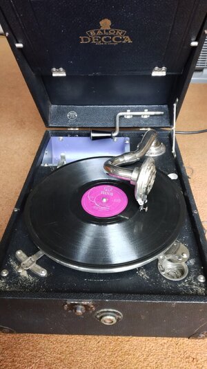

Those "nails" will certainly clean gunk out the grooves (and remove most of the music too)!
I remember my parents having a Ferguson unit with the stylus that flipped over from 33 to 78.
I still have one of Dad's old shellacs but nothing to play it on. I guess I could manually spin the Planar 3 at 78rpm and stick a sewing needle between my teeth. Then again, maybe not!
Sewing needle and a matchbox as a speaker works fine :) Been there, done that, in my yoof.
