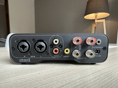

This quite tiny amplifier is equipped with stereo RCA and balanced XRL inputs; classic speaker terminals (supporting banana plugs or bare wire connection), plus an output for an active subwoofer. In addition, there is a 12V trigger available on the back panel: this feature allows to power on/off the ZA3 especially if you use two of them in pair as mono amplifier.

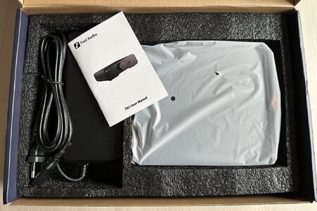

Packaging and esthetical appearance: the Fosi ZA3 amplifier arrived with a nice compact package that includes the power adapter with cable, which will match the one used in your country, and manual user.

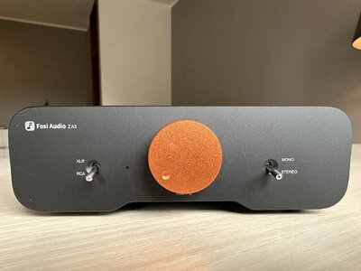

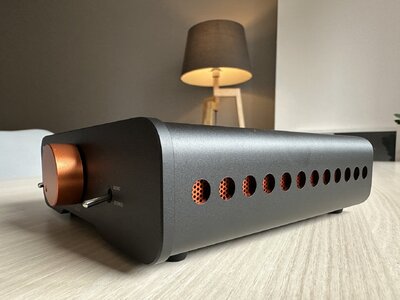

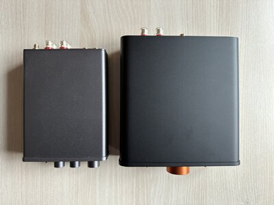

I like very much how the amplifier looks like and how you can feel it in your hands. The case seems to be very solid and give you a good impression and the effort that Fosi has put in the design is also quite clear with the choice of colors (I love the orange knob) and the side holes which, in addition to being very useful for heat dissipation, are very attractive due to the presence of the net with the same color of the knob. The size is a little bit bigger compared to my Fosi BT20A Pro, as you can see on the third picture, but remain still compact allowing more space for more connections.

But…there is also something that I’d suggest to modify on this amplifier. For instance, the mono/stereo switch could be placed on the back or underneath (you do not need often to switch from mono to stereo, or vice versa, once you have defined your setup). Instead, I should appreciated that this switch could be used for the power on/off, to avoid frequent accidental change of volume setting especially in mono mode.

I agree that the two front switches belong on the back, as they are used once in a blue moon. An on off switch however, would be ideal on the front.
I suppose the RCA / XLR switch might be handy as a source selector for some.
But stereo / mono should certainly be on the back....if it's accidentally switched does it suddenly whack more into just the right speaker? :unsure:
Maybe you will (try not to) find out (y)
