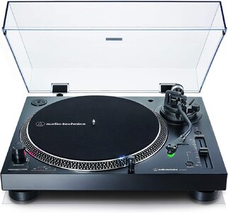

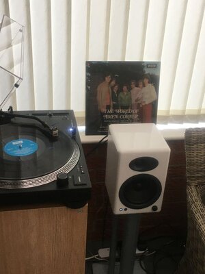

I bought this turntable as a second turntable for conservatory use. It's within your budget easy to change speed and has a built in phono stage. I will say that I have a more expensive turntable in my main system but this unit really does surprise me with it's sound quality and it can be upgraded by buying the next stylus up the range at a cost of around £40 but it's not necessary if the sound is right out of the box. What will the rest of the system be I use mine with wireless speakers .
Here is a photo of my system with just the turntable and speakers403606333_3498484953738916_7027185177230309901_n.jpg

That one doesn't get favourable reviews it only got 3 stars on here. I had one of their belt drive models and the motor sound was terrible I sent it back and bought the one I posted and am very happy with that one.

Thanks so much for all your advice! Just got off the phone to richer sounds. They said rokit speakers won’t work because there’s no right socket? That I would need active speakers, ideally steljas? They also recommended the audio technic 120 after I mentioned it…. Reading all the messages and appreciate them
Reactions: camcroft
The problem with the Rokits is that they only have balanced inputs. The 120 only uses RCA connections. I have checked on Amazon and I see that they sell connectors from RCA to XLR ( Balanced ) the question is will they work.

The bottom line is that if you were to buy Camcroft's turntable in post #2, it could be connected directly to the Rockit speakers (or go via the mixer if preferred).
Note that the mixer has built-in phono preamplifiers.....which means that if the mixer stays in the setup, then any turntable you buy does not have to have a built-in preamp.

Based on your gear, perhaps an Audio-Technica AT-LP60X (currently the best selling turntable in the world) would be just fine?
It's what most of the millennials are using to play their highly priced and poorly pressed Taylor Swift LP's on.
It's about the same quality as a 1970's Garrard AT60... which is what most people listened to their vinyl on back in the day and so you will definitely get that 'authentic' vintage vinyl sound (don't get me wrong, in the days of yore Garrard did make some fine turntables... the Garrard 401 was used by the BBC in their studios) and a restored 401 with SME M2 tone arm today (mounted in a heavy plinth) would wipe the floor with most new turntables.

Personally, on a limited budget I'd get the AT-LP120 and a Knosti Disco Antistat to thoroughly clean the record collection before anything is played.

Either the AT-LP60 or the AT-LP120 would suit his needs, or anything between these models.
