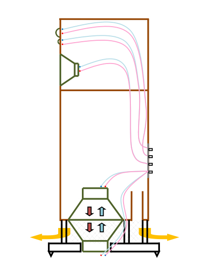

Hi.
I know this was discussed at length on here some 2 years ago but I can't find the thread. Now that the likes of Davedotco are on here I should like some opinions please.
What do you think of this type of loading in a loudspeaker?. Good, Bad or never heard one?. The design intrigues me that's all.
On a theoretical level I have never really undestood the advantage of isobaric loading. Resonant frequency of the drivers are largely unchanged, the movement of the bass drived might be a little more linear (the air in the enclosure is not compressed) and the enclosure can be made smaller (but not by a lot).
On the other hand, it is complex and expensive, the extra power handling does not give a substantial increase in output and in the designs that I am familier with, results in a pretty low impedance.
That said, apart from the two old Linn models, I am struggling to think of any examples. I believe Neat have used this technique in recent times, maybe you should speak to Bob and his team.......*unknw*

Spoke to Bob ages ago. See Dave, I've got this idea of using 2 Isobarically loaded pairs in each cabinet. Spiced it and it all seems to work ( in theory anyway ) with a pretty benign 8 ohm load ( 6.3 resistive ). I wouldn't mind so much if it was just a ponder, but it just won't go away. Driving me nutso!!.*dash1*
If you got those IMO impressive 8 ohms and >84dB, I would definitely vote for such a speakers to be made. Those would be rare gems on today's market.
We all get these crazy ideas.......*wacko*
I'm still at a loss to see what advantages such a configuration would bring to the table, perhaps you could explain what this would achieve over, say, a much better and more expensive single driver in an appropriate enclosure.
As for working on 'silly' ideas, back in the day when i could do this sort of stuff, I had a project involving my favourite bass driver, the JBL 2212, and the then very rare TAD compression driver as a high power, two way domestic monitor. I got as far as having the cabinets built, got BSS to build me a custom electronic crossover and was chatting to Westlake Audio about their 'baby' 1 inch wooden horn for the TAD.
Then I started to think how much this was costing.........

You sitting comfortably Vlad??. Try 88/89dB @ 2.8 volts!!!. This is the bit that's driving me nuts. And all in an enclosure 100cms tall, 24cms wide, 28cms deep. Crazy right??. Checked the model 9 times now. It's right though.*wacko*

Time to stop computer modeling and start building. Just build the bass section and see what you get in practice, if it works you can design the rest of the speaker to suit.
Tiny enclosure, can you really maintain accurate isobaric loading in something that small?

What it means IF I cabinetise it, is it will realise more significant Bass output from a 'relatively' small cabinet whereas if I went down the single driver route the cabinet would a) have to be twice the size and b) it would have to be reflex loaded. Imagine a monster like that with all the room boundry issues it would have. A complete non-starter IMO.
As regards cost, I have all the bits I need in stock. Just have to build a pair of cabinets. The question is (?????) would it sell if it worked?. Sensitivity wise it should be OK to drive with a relatively 'small' amp. Impedance is, as I said relatively benign at 8 ohms. That's my dilema. Hence asking for input.
The trick I think is matching the parameters of the drivers. I can check em individually on Clio. Plus, the closed box should help to keep things tight ( I hope ). Still haven't gotta clue wot I'm doing this for though.
I was under the impression that you could not make the isobaric setup too small due to pressure in the second chamber but I am absolutely no expert here.
I guess the big question is whether or not it would sell, everyone wants floor standers in the current market but as far as I can see, they want them cheap and with loads of bass.
Would enough people understand and purchase a big (ish) speaker with a flat response? I genuinely don't know, with that kind of sensitivity they should demo ok, but without the 'obvious' bass presence will they be chosen?
In comparison to the isobarically loaded Neat Ultimatum XLi, that's the same height, 2 cm wider and 9 cm shallower. So aside from the 9 cm extra depth of the Neats, it's very similar. Neat claim 87dB sensitivity.
Both Linn Majik Isobarik and Neat Ultimatum XLi are ported. Richard said he tested a closed box in Clio and got an easy impedance and good efficiency. A true Olson isobaric design, 64 years old now.
