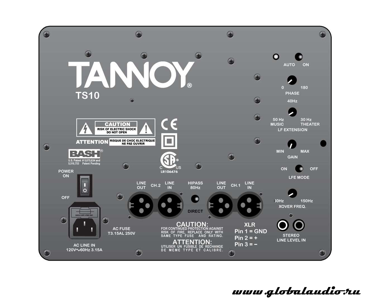

I presumed it has moved as sub isn't extremely heavy, in fact I thought it was going to be bigger and heavier than it is. So are you saying to place on the granite slab then place a concrete block on top??
Setup below
Gain at 11 o'clock, dial turned to theatre, freq turned to 150htz as amp/BD crosses at 80htz and LFE switch is turned to on.
Does this sound correct? Oh phase at 0.

This one?
Try reducing extension to 40 +/- 5, try reducing gain, try changing phase (is it set corectly? if not, the driver may be flapping too much but without producing enough volume of sound), try switching off the LFE mode. Crossover - are you sure teh amp/bd only sending frequencies below 80 tot he sub? if not, reduce crossover setting to nearer to 80 or 70. Basically, try to get the driver to work more cocmfortably, it may be too much for it - the sub should not vibrate and move around.

AlmaataKZ said:
This one?
Yes this is the one.
I will definitely give it a try, as my CA BD player does the bass management for HD Audio it crosses over at 80htz for defo. Amp itself is set at 80htz too but I will try moving LFE switch.
