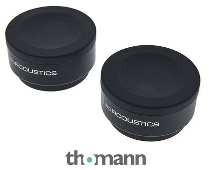

gasolin
https://www.thomann.de/gb/isoacoustics_iso_puck_mini_set.htm
https://www.futureshop.co.uk/isoacoustics-orea-series-isolation-feet (you need 4 pr speaker)
https://www.futureshop.co.uk/isoacoustics-gaia-series-threaded-isolation-feet (you need 4 pr speakaer)
