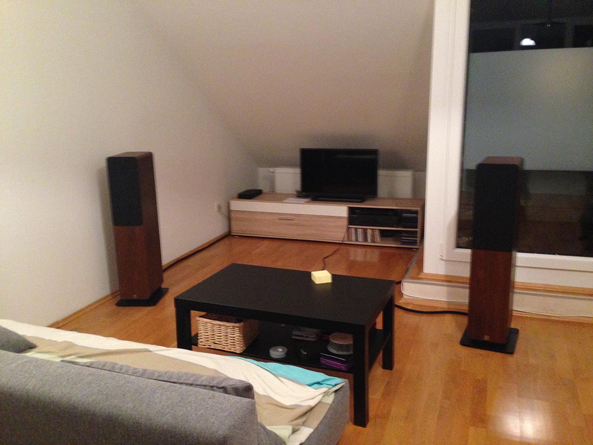

And thats how the speakers are set in the living room:

It's all a bit close and tight for big speakers but I think you have simply bought the wrong equipment for your taste.
Return then if you can and buy something else, that said the Cambridge amp is not the leveliest either.

The distance between spakers should also be the distance from each spakers to the listening position, seems theres to much distance between the speakers or to little from the speakers and the listening position
left speaker is to close to a wall so it will have more bass.
Try a different amp

Speaker positioning is all wrong I'm afraid. About as wrong as you can get. I'd give them a chance but reposition them .
At the moment there is plant of space behind left speaker but it is way to close to that sidewall, the right hand speaker is free from sidewall but has what appears to be a patio door behind it (way to close). They are also too far about relative to listening position.
If you can rotate your listening position through 90 degrees and have both speakers positioned along that wall to the left of photo, as far from the wall as you can permit. This set-up might change the sound dramatically. NOTE: This would only work with music, not so good if you are trying to watch TV *biggrin*
If you simply cannot re-arrange your listening position you are probably going to be better off selling them and getting a pair of small stand-mounters to fit just inside the mouth of the alcove.

I agree with Al ears
Get the tv away from that radiator and put your kit against the side wall.
Even standmounts in that hall clove will create problems with sound.

I will reposition speakers on the weekend, and will record that with any type of mic I got just to get comparison. Will keep you posted! TV will stay where it is, still got a room for that as it is 25 square meters. Thanks for all the tips. just can wait for the weekend!
