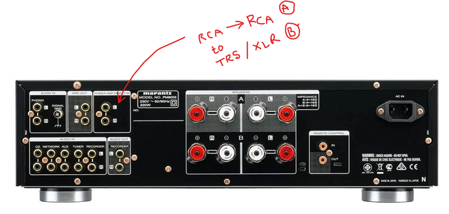

Your Marantz PM8005 has RCA LFE, it has separate mono left and right outputs, it gives you some flexibility.
My AV setup I'm using DALI E-9F subwoofer, these work well with my Monitor Audios. Some subwoofers come with a single LFE , so you would need Y RCA cable, which is pretty straight forward. I think the Marantz allows you to adjust the Low pass via the controls.
You can use a professional subwoofer if that is something that appeals to you. Some provide RCA connectivity but most likely you would require an adapter cable RCA to TRS or RCA to XLR.

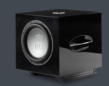

REL Acoustics S/812 - Active Subwoofer Class A
https://www.google.com/url?sa=i&url=https://avstore.in/products/rel-s-812&psig=AOvVaw1DMVWQZF5u546hhXdr61wV&ust=1692464300281000&source=images&cd=vfe&opi=89978449&ved=0CBAQjhxqFwoTCNC7n53Z5oADFQAAAAAdAAAAABAL

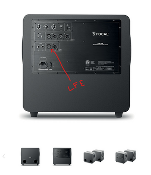

Focal SUB ONE (Focal is possibly a French version of British KEF) - also see their non-professional range of speakers - floor standing or subwoofer

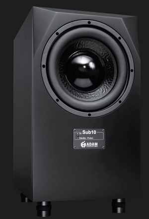

Or possibly
ADAM SUB10 or SUB12
