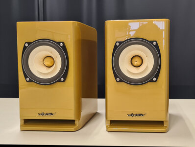

Vincent Kars
The problem with full range drivers is that they are not full range. I do think calling them wide banders is more apt as they don't go low (can indeed be compensated by a sub) nor high as the treble is often rolled of at 18 kHz. This can be compensated by getting older.
The closest we can get is a 2.1 where the bass is handled by a woofer, the mid range by the woofers of the satellites and the treble by the tweeters.
Of course there are full range systems claiming 40 - 20.000 Hz (without specifying the tolerance) like https://voxativ.berlin/ampeggio-2023. With 40x120x40cm not exactly bookshelf but at only $13,900.00 it is yours.
