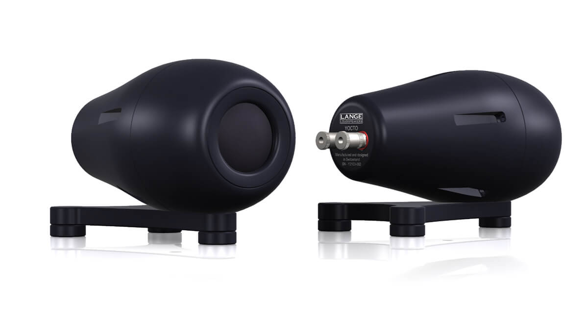

https://www.langeloudspeakers.com/products/yocto
