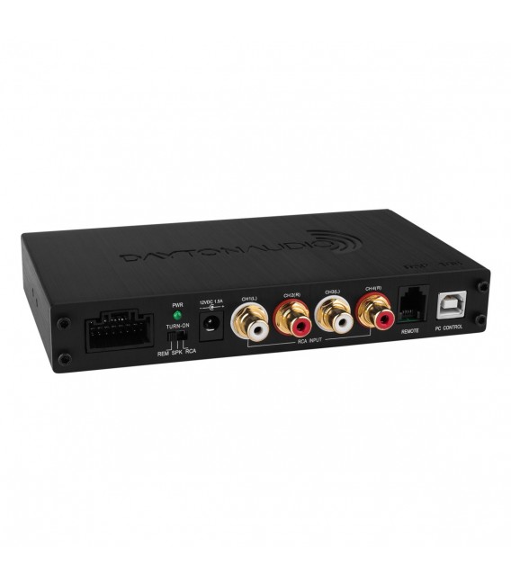

I'm not totally sure what you are trying to achieve, or to be more precise the benefit of what you are trying to achieve.
Can you not set up with digital base management, then control the bass volume with the volume control on the sub?
Reactions: Kenneth Fernandes
Dsp ??
