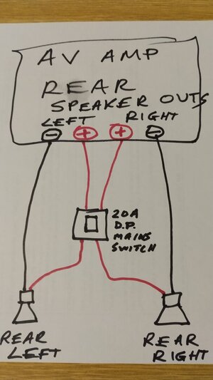

If the manual doesn't mention a way to cut the back speakers for front only stereo, you could always do that with your own single, physical switch.
You only need to break the positives to each rear speaker:IMG_20260422_005415.jpg
Plastic or fancy metal double pole switches are widely available.
'DOUBLE POLE' switch (not to be confused with the more common 2-way switch)....
