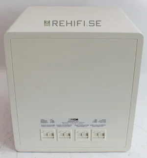

The subwoofer is not my speciality.
How was it connected to that receiver?
Some you simply wire into the amps speaker connection.
This is what the subwoofer looks like on the back. You connect the speakers with audio cables to the subwoofer and the subwoofer to the amplifier.
