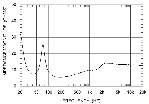

I actually own a pair of Amphion Argon 2 anniversary (basically the same as Argon 3), I like them a lot, beautiful and full sound, but these speakers do also prefer solid state in my opinion, the bass simply is more controlled. How come System Audio work so well, a danish brand?
The speakers are built to different Q values (their inherent damping). A low Q speaker (critically damped or overdamped) will not need the electrical damping offered by an amplifier with a low outuput impedance (high damping factor). Such speakers are ATC which are overdamped IMO, but they are too insensitive for low power tube amps.
Now, if you have a high Q speaker (underdamped) the designer will expect to get the required damping from the amplifier, as is the case with Dynaudios and most speakers, otherwise the speaker will sound bloated and uncontrolled.
Another aspect to take into consideration is that a tube amplifier with a high output impedance will have a frequency response that follows the impedance of the speaker. Most speakers have an impedance rise at resonance in the bass region which translates into a bass boost from tube amps.
Bellow is the impedance of the Argon3, you can see the rise in impedance at about 70Hz; well, imagine this is the frequency response of your tube amp. An amplifier with a low output imedance (solid state) will not have its frequency response affected by the impedance of the speaker so you don't get that bass boost at resonance.
If you're interested in the subject you may want to read these articles.
http://lenardaudio.com/education/14_valve_amps_7.html
http://lenardaudio.com/education/05_speakers_3.html

and those are exactly the reasons why I claim the best match match for a tube amp is flat panel ribbon speaker 🙂.
first of all; they present almost purely resistive load (in most cases flat 4 Ohm load with a small bump in xover region). in such a case high output impedance of the amp is irrelevant because it sees almost constant impedance from the speakers. so it can't change its frequency response along with changing impedance as in case of moving coil speakers. below impedance plot of older Magnepan MG3.6/R for your information. (ideally the impedance of the ribbon tweeter could be slightly higher, the right hand side of the graph).
second of all; the problem with diaphragm control. planar bass panels work differently from moving coil cones. they have much larger surface so they have to make only minimal movement in order to excite the surrounding air accordingly. and because of the fact that the moving mass is much lighter than in case of moving coil speakers the the same air provides enough of necessary damping for the diaphragm! high or low damping factor of the amp is completely irrelevant in this case. that's one of the reasons why planar bass is so quick, tuneful and not exaggerated. (others being naturally low harmonic distortion in low bass region and also lack of "enclosure thump" so common in case of many box speakers.)
the only problematic feature may be lowish efficiency of planar speakers (usually between 80 - 86 dB @ 1m @ 1W) which does not go well with naturally lowish output power of the tube amps. however, when you take into account the fact that the sensitivity of planar speakers lowers at a half rate of typical moving coil speakers things start to look not so bad after all. in other words an 86dB/1m efficient planar speaker at 4 meters is as efficient as 92dB/1m moving coil equivalent!
if you can accommodate planar speakers in your room you should certainly consider them. mind you, I now own Mgneplanars MG12QR at the moment but used to have Dynaudio Focus 110. IMO Maggies now that they are fully ran in (and it takes an awful lot of time for those speakers to run in) beat Dyns in every aspect of audio reproduction. and the Dyns being no slouch either...
