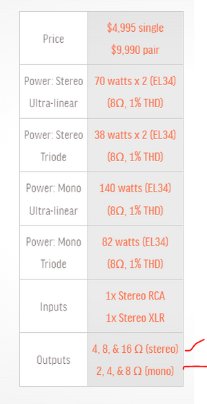

Surely the Prima Luna EVO400 is a stereo power amp? You do not want two of them and the monoblocks are around 9900 dollars per pair, did you mean these?
What do you intend to use as the preamp? The PrimaLuna EV400 preamp?
Rethink needed?
You probably wouldn't notice much difference by using one stereo power amp apart from saving yourself 4500$
Regards speakers 4ohm connection should be better.
Thanks for all the replies so far. I will try to arrange a listening session for both tube and solid A amps. Probably will still go with tubes, since I always liked the tube sound. But good (and fun) to compare. In case I'll decide to go with tubes : I connect my input devices (streamer, vinyl) to the pre-amp, connect the pre-amp left out to one power amp and the right out to the other power amp. Correct so far? Then the power amp (probably Primaluna EVO 400) has different speaker outputs, marked with 16, 8, 4 and 0 impedance. My speakers say: 4Ω nominal (Compatible with 8Ω). Is it better to connect them to 4 then?
This is very helpful for me, so big thanks and also apologies for stupid questions 😁
If you bridge your amp , i.e. two Primaluna EVO 400 running as mono blocks left and right, the output Ω can work with speakers with variable ohms inputs from 2Ω to 8Ω.
If you have it setup as a traditional stereo, the amp's output is able to operate from 4Ω , 8Ω and 16Ω. If your speakers only handle 4Ωs, it should be perfectly fine for the amp. Though, I can't see from the specs the amps watts output rating for 4Ωs. Below are the specs for 8Ω

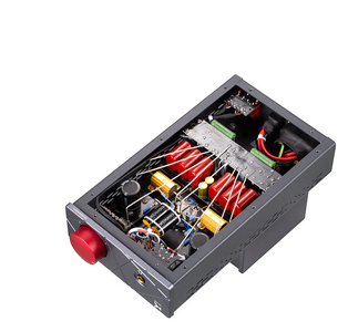

I'm having a tube renaissance myself, I decided to invest in XDUOO TA-66, maybe get into tube rolling, that's another discussion 🤣
No circuit boards - Point to Point Wiring - ooooooh Aaaah 🙂

I don't think PL has a current line of (solely) monoblocks - you buy a stereo power amplifier and bridge it. As such, I'd build into this if possible:
Stage 1: streamer (hopefully with pre-amp / volume control capabilities) into 1xEVO 400 in stereo mode
Stage 2: as stage 1, with 1xEVO400 pre-amplifier into 1xEVO 400 in stereo mode
Stage 3: as stage 2, with 2xEVO 400, bridged in mono mode
Also, PL do a hybrid amplifier if it is an attraction to the brand.
At least they call it a mono amplifier
