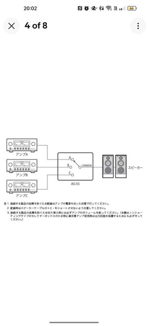

Based on the feedback from knowledgeable and amazing members of this forum I think I have found the decent switch - Luxman AS-55. It seems to do exactly what I need, but I'm not sure it will work with monoblocks. In the manual I can only see individual amps (attached) but I need to switch between a) two monoblocks powering individual speakers b) an integrated powering both speakers. Am I missing something here?
To be fair the monoblocks will obviously need a preamplifier and, as you see, it will probably only work with integrated amps. The amps are connected to the switch and only one pair of speaker cables connect the switch to the speakers.
Well, that shouldn't be a problem. Evo 400 pre-amp connected via XLR to two Evo 400 monoblocks. One monoblock connected to "right" input of "system A" on AS-55 and the other monoblock connected to "left" input of "system A" on AS-55. Then the integrated amp (SU-G 1000) is connected to both "right and left" inputs of "system B" of AS-55. And the AS-55 connected to my loudspeakers. In this way I can choose if power my loudspeakers via EVOs or the SU-G1000 at leisure via the AS-55 selector. Makes sense or I'm gonna mess it up ? 😁
