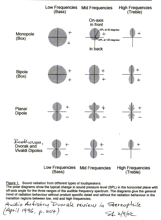

Apart from the tweeters which beam at high frequencies small speakers do radiate almost omnidirectionally. Try turning a small pair of bookshelf speakers around 180 degrees so that they're facing away from your listening position. You'll likely find that the treble is reduced in volume a bit but apart from that the sound will hardly change.
don't tell me you did this experiment yourself with your computer speakers. you just turned them around and then sit and listened what happened? ever heard about sound reflections? try to do the same experiment outside in open space (at least 10m - 15m clearance from boundaries. I know, there'll be a problem with floor distance but you can ignore this one for once) if you have long enough speaker cables. that way it's going to be much better approximation of anechoic environment than when your speakers face a wall in your room :rofl:
BTW this "omnidirectionality" of small speakers in your room should tell you a word or two about how prone dome&cone speakers are to interacting with your listening space.

Yup Steve:
"Apart from the tweeters which beam at high frequencies small speakers do radiate almost omnidirectionally. Try turning a small pair of bookshelf speakers around 180 degrees so that they're facing away from your listening position. You'll likely find that the treble is reduced in volume a bit but apart from that the sound will hardly change."
That is complete twaddle. What you are hearing are reflections rather than radiation. A boxed speaker will only radiate sound omidirectionally in the low bass (Below 100Hz or so) and everthing above that will be monopole.
And dont just take manufacturers guff as gospell. They are all trying to sell you their products. If you want some real speaker theory, read up on independent sources from the internet and books.

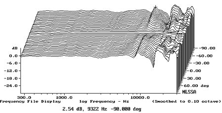

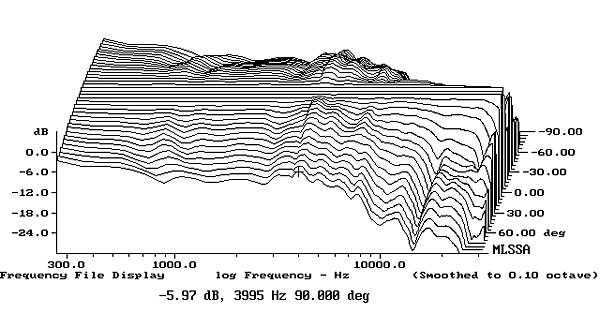

this is not about agreeing to disagree. this is not a dispute about personal preferences. this is about science and hard facts. I thought I'll show you some pictures too.
this is how horizontal dispersion looks like for a typical, front firing, multi-driver box speaker:
some will look slightly better (smoother transition off axis) some much worse (more lobbing). but one thing for sure. you'll see how spls diminish when moving further off axis and further up the frequency spectrum. this is certainly no omnidirectional behavior.
and now; this is how an omnidirectional speaker dissipates:
see the difference?

The speaker that produced this graph is the Sony SS-AR2 which is a large floorstanding speaker not a small bookshelf speaker. You will find that small speakers are more omnidirectional than that below 10kHz.
http://www.stereophile.com/content/sony-ss-ar2-loudspeaker-measurements
Even with that very large floorstanding speaker everything below 10kHz is still fairly omnidirectional on that graph. Apart from the dip at around 2.5kHz it's only the high frequencies above 10kHz which decrease very rapidly off axis.
Which is what I said earlier.

I am sorry, in no way is that dispersion omnidirectional, and remember thats only up to 180 Degrees, if they did a 360 Degree plot (which would be useless) you would see that it would drastically reduce all output below 1Khz when you get past 180 Degrees.

...and as I said:
"The speaker that produced this graph is the Sony SS-AR2 which is a large floorstanding speaker not a small bookshelf speaker. You will find that small speakers are more omnidirectional than that below 10kHz."

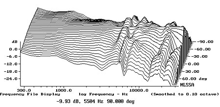

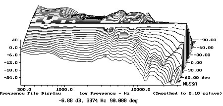

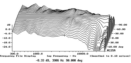

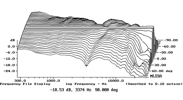

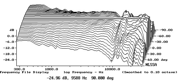

Some small speaker comparison:
TAD Compact Reference CR1
Joseph Audio Pulsar
Harbeth P3ESR
PMC DB1i
ATC SCM 11
I could go on but none of those are much different to the Sony one posted before.

sorry Steve. but if some 10dB dip @ 1kHz @ 90deg. is still omnidirectional to you then we must be talking about completely different matters.
BTW happy listening to your "omnidirectional" monitors sitting next to them :wave:

One thing I will agree on. Dipole speakers such as open baffle speakers, Electrostatics and other panel speakers have a 'figure of 8' radiation pattern. So if I put my ears at the side of the speakers, even at high levels you hear almost nothing but room reflections.
Speaker Directivity
http://www.linkwitzlab.com/rooms.htm#B
