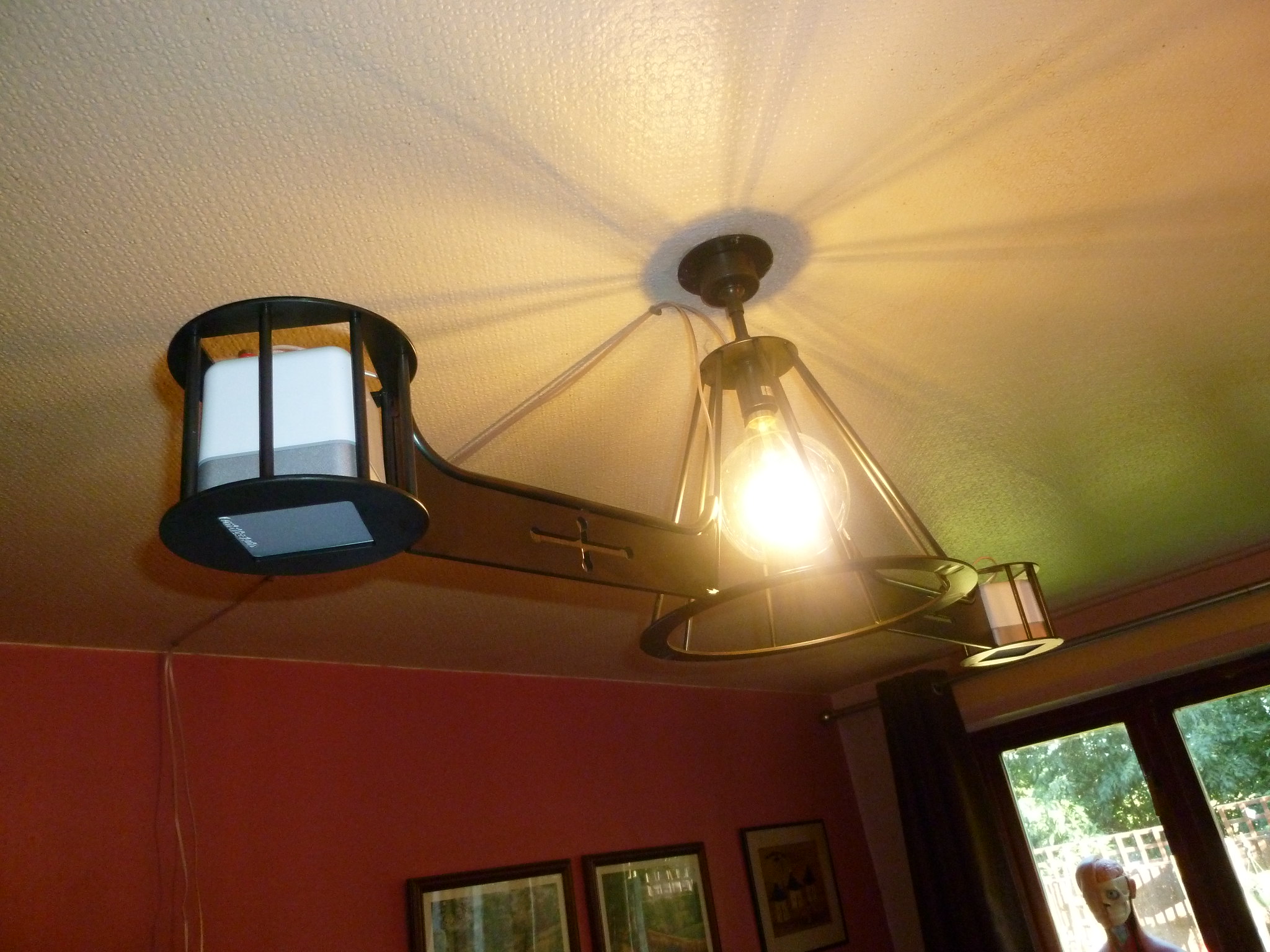

I got my atmos speakers sorted today so far watched expendables 3 and john wick and not very impressed with atmos, *sad* i have re-run the audyssey and the speakers are working am i doing something wrong ?

In the last half an hour i have just altered the dynamic EQ which has altered the sound so i don't know if that will make a difference, btw the amp is a Denon AVR-X2200W.

ideal av
Apr 23, 2012
and so did I on the other forum
you cannot blame Atmos when your implementation of the speakers will ruin it for you, your main interest was the light fitting when you came to me to hear Atmos
you said you loved it but wouldn't or didn't take good advice on board which is a shame
you really do need to take notice or whats the point in asking for advice in the first place
bin the light and or move the speakers and you will then start to get good Atmos
