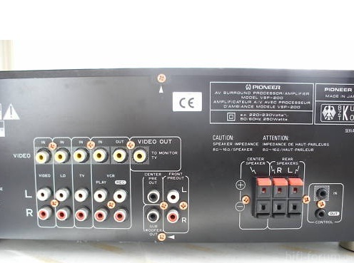

hi just bought a new samsung smart TV model 6400 . I can't seem to get any sound from the audio outputs red & white I'm putting them into the back of a pioneer vsp200 surround sound amp . I didn't have any problems with my old pioneer plasma this way I even tried putting them in the back off my k2 roksan still no sound at all any help would be welcome.

Thanks daveh75 didn't think that been 11 years since I bought my old plasma.so Is there anyway I could get sound do I have to use hdmi only prob is my av amp don't have any hdmi on it?
Does your AV amp have an optical digital input? (The Samsung has one optical digital output.)

Thanks for the reply chebby no it doesn't have an digital input think I'm screwed .looks like I may need to buy a new av amp any suggestions would be appreciated as long as there not to much ££ also I'd need it to be able to run with my roksan k2 as they drive the front speakers.

What AV reciever is that you have? Optical inputs/outputs have a little black peg in them, i'm sure you know this. You have to take the peg out so yu can connect a cable.
See Opt 1 and to it's right is Opt 2 with the peg in. Again sorry if you already know this. There should be a matching socket on your TV as someone else mentioned.

No optical inputs on the VSP-200
Your cheapest option would be to buy an inexpensive DAC like this for example
An A/V amp with pre-outs (to use with your Roksan) wont be cheap unless you find a deal on an older model or buy used. Pre-outs tend to be reserved to the mid range up these days.

Oops I did reread his original post but somehow didn't pick up the amp part. I figured it was too old tohave had any digital connections.
