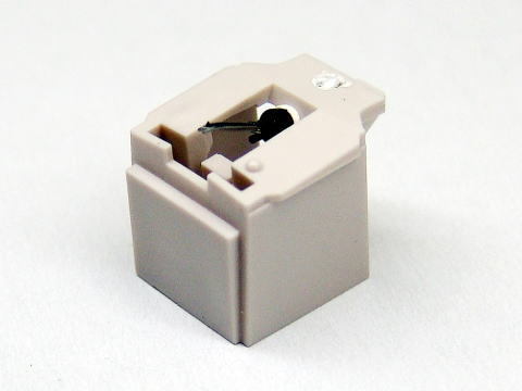

Can you mention any that are a straight swap on a Rega Carbon?just change the stylus to a hyper elliptical or shibata

Carbon Shibata Stylus for Cartridge ( Carbon )

Carbon looks like an Audio Technica AT91 so perhaps some of their stylii fit.
carbon cartridge is a $12 chinese built unit , replace the stylus & they sound great
