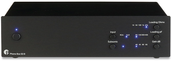

The spiel below is taken from the blurb on Project's web page for the X2B, hopefully this makes some sense;
Balanced audio connections are usually known from the professional sector like recording studios or live concerts. It is very important to have a stable & interference free connection, as these signals will be highly amplified. The same applies to the connection from your turntable to the phono preamplifier. The big advantage of a balanced connection is its ability to remove picked up noise and interferences. And best of all, cartridges by nature are already balanced signal transducers! With True Balanced your are simply using everything, literally everything, that your cartridge is picking up from the record groove. You are not throwing away half of the usable signal, like is done in typical single-ended RCA phono connections.
The X2 B comes with mini XRL and RCA outputs and with our standard semi-balanced Connect it Phono E RCA cable. By upgrading it to our fully balanced mini XLR to mini XLR version (available separately) and using a balanced phono stage, like our Phono Box S3 B or DS3 B, you are fully set-up for the True Balanced experience. This leads to increased dynamics, less noise and improved signal to noise ratios. You can imagine it, like hearing parts of your music that literally were not there before.

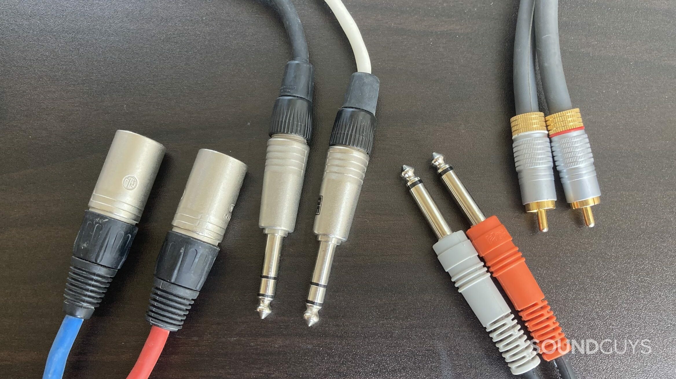

Balanced cables also, down to the way they handle signals, are also better at all forms of noise rejection.
This is particularly relevant when dealing with very low voltages that you get from a vinyl based front end, perhaps less so when dealing with an amplified digital output, as you note.
Put it this way, if I could somehow make my turntable / phono preamp set-up balanced then I would. :cool:
Note: this would only apply if you use a MC cartridge in the first place...
Gray
That's the point.
For a metre or two of line level interconnection it's easy to see balanced as unnecessary, a bit of a gimmick.
But with just a few millivolts of signal out of a cartridge this has the potential to be far from a gimmick - credit to Project.
I wouldn't be surprised if they use starquad balanced cable all the way from cart to their box too, which has proven additional interference rejection.
How balanced works is that the screen is only a screen - it's not used as a signal return.
You've got two equal twisted conductors (4 in the starquad cable) carrying the signal.
That balanced box of theirs 'looks' at the pairs for differences. Unlike the wanted signal, interference affects each of the pair legs differently......so it's easily found and very effectively rejected.
