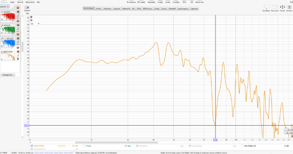

this is my rew measurement after dirac live bass control and has nulls maybe 2nd sub will fill the null or not?
You have a big null around 77hz, which is close to the recommended crossover of 80hz.
Chances are a second sub would help with the null as the frequency response in a separate location will be different.
The more subs, the more balanced the bass across the room.
Reactions: hardcore_gamer29

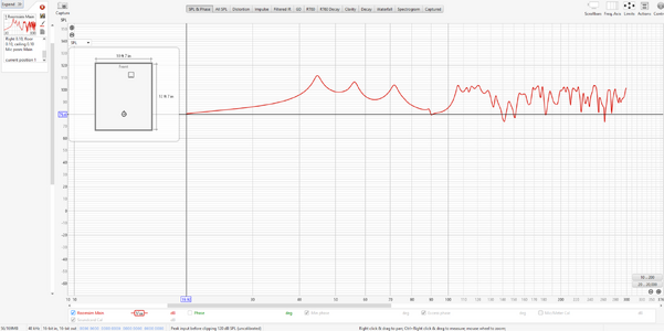

ok i can add another sub but can place in front only to the right of left front speaker. will it be good? it will be exactly same distance from left and back wall as my current sub is from right wall and back wall
You said:
"i tried room sim before 4 months ago but the thing is how rew takes subwoofer distance into consideration? if back of subwoofer body is only 3 inches from front wall will rew consider it 3 or from front where cone is?"
REW (if I recall correctly) measures the distance from the cone as opposed to any other part of the sub. Less of an issue with down firing subwoofers!
ok so for cone i guess i need to take into consideration front of subwoofer to front wall ?
