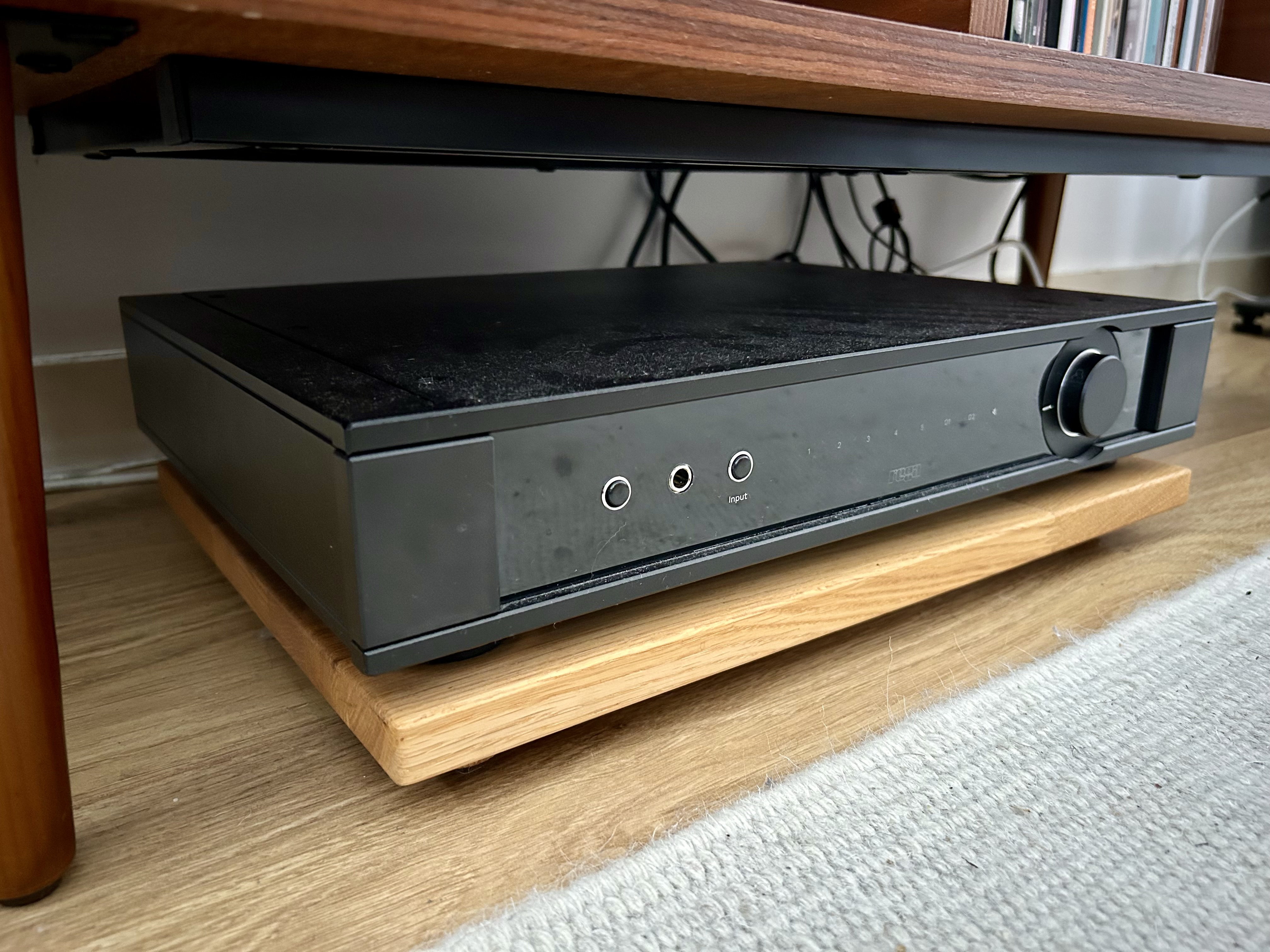

The heat-sink design on the Rega amp is poor. With the amp being stuck underneath a cabinet there is no airflow around the unit which exacerbates the problem. Heat rising from the amp is getting trapped underneath the cabinet and stagnating around the amp.
The amp has tonnes of room down there. Granted the width of the cabinet will trap a tiny bit more heat, but I doubt your everyday hifi stand is going to make any difference.

But should he have to do that? The amp should be designed to remain stable on a normal shelf, furniture or hi-fi stand. And on the floor will be the coolest part of the room - not like it's sitting on carpet.
If cables are long enough it won't cost anything but time to try, both air,space under and over the amp + right and left side
Then we can rule that out if it doesn't make a difference
He can try what ever he has that is 1-2 inches tall under each feet
I guess he won't use it with the cover off but that could also be someting to try
It's a high performing amp that shouldn't get to warm but considering the high price and the power it has 105 watt pr channel in 8 ohm,162 watt in 4 ohm, it has no holes in the top plate,cover of the amp, like most amps have and might need all the space it can get to dissipate the heat
The thermal cutout should only occur with continuous over-driving of a difficult load. If it occurs under normal conditions, there could be
a problem with insufficient airflow around the heat sinks or a fault with the loudspeakers

I still don’t understand what difference this location will make compared to a shelf on a hifi rack?
Not a matter of what difference it makes but if it makes a difference with a better placement of the amp

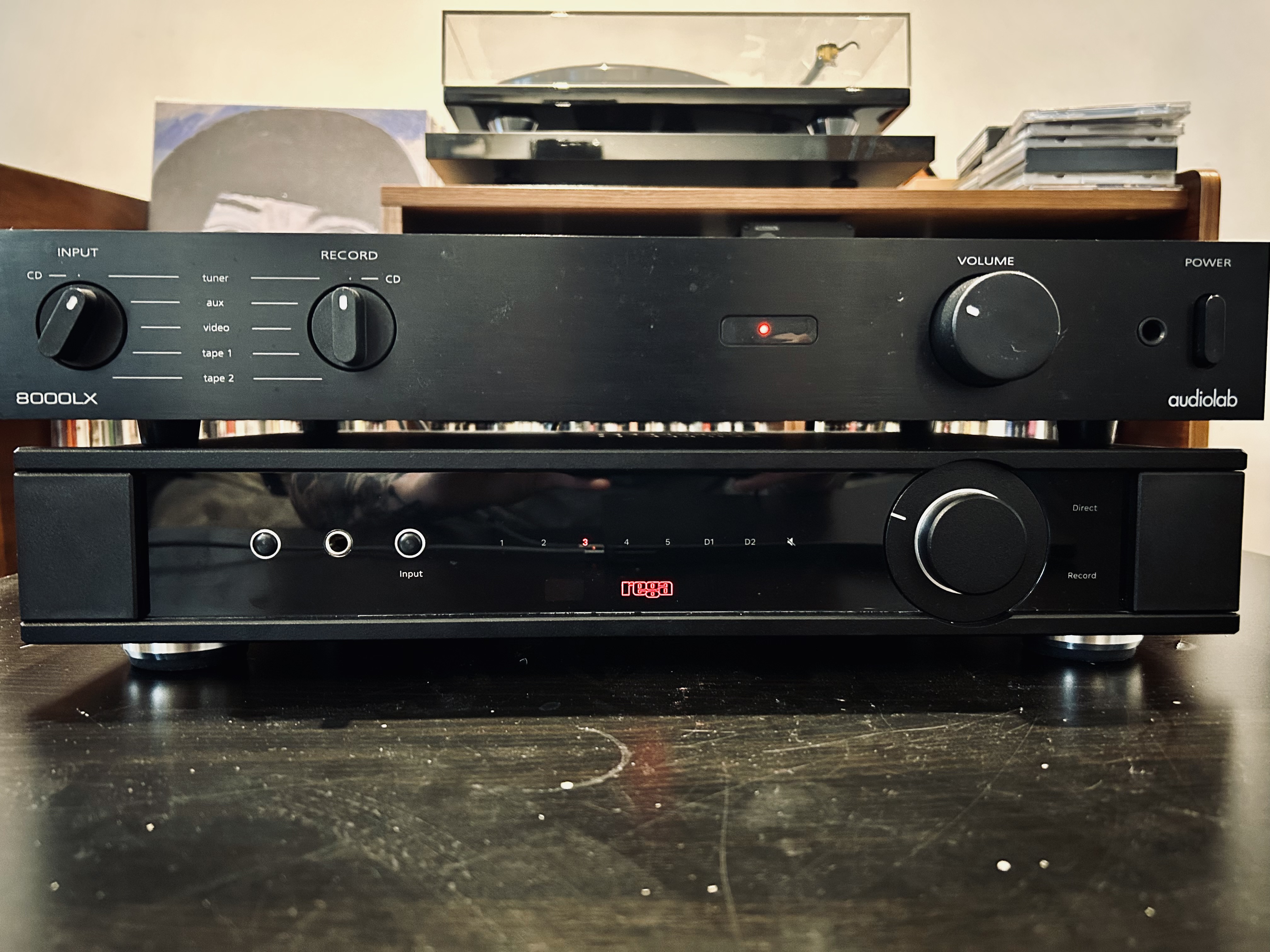

Experiment 1:
Elicit mk5 vs a classic that can push 2Ω​
I didn’t have much of a plan beyond searching for a cheap integrated that was well-regarded & comfortable pushing hard to drive speakers. The main candidates were NAD 3020, Naim Nait 50, some Yamaha models, Cyrus & a few others. Then I stumbled across the Audiolab 8000 & it quickly stood out for me due to descriptions from people who loved it (& from those who hated it). I came close to picking up an early version until I saw some criticism of the preamp. I did some more reading about all the different versions, incl. the 8000s (with the F serial number). That finally led me to the 8000LX which apparently has all the good stuff of the A & S, with none of the bad stuff. Within a few days an LX appeared on eBay, so I jumped on it for £180.
Audiolab 8000 LX
1998
£700 (c. £1,540 adjusted for inflation)
60 W per channel into 8Ω
Rega Elicit mk5
2022
£2,000
105 W per channel into 8 Ω
Did a quick a/b with a few modern folk & country songs. Mostly for quality production with layered mixes featuring prominent, quick-moving basslines & lots of acoustic drums, guitars, banjos, pianos etc…
(I should interject here & highlight that the only thing really being tested is how unreliable I am as a judge.)
Things get off to a great start with the Rega. Then I hit the first, and quite fundamental challenge to even remotely compare these two fairly: the Audiolab doesn’t have banana jacks 😱 after a few a few minutes wrangling with the speaker inputs, I managed to get things playing. Instantly my first thought was that the Rega was leagues better. Then I remembered it was louder with the other amp, so I turned it up. It sounded much better. By this point, though, I’d forgotten what the rega sounded like.
Cut back to me getting the volumes near level & testing again. The time it takes to switch the amps really kills any ability to get a feel for a direct comparison. The strangest thing was happening every time I plugged in the Rega: it seemed like no contest. But then after swapping over to the Audiolab I couldn’t hear anything missing or less clear in the mix.
The winner: Rega (only just)
All I can say is the highs sounded slightly more crisp on the elicit, and the 8000 was a bit bass heavy & slightly boomy in comparison. Apart from that I would go as far as saying I think they sound pretty damn similar. Both are excellent with lovely 3D sound in the mix, loads of clarity & separation. I think the word for the Rega would be ‘refined’, yet the difference would probably be imperceptible with day-to-day listening.
Colour me surprised. And also unsure of myself. I was expecting to instantly box up the 8000 & start looking for a different cheap amp that might be able to compete. Lots of good amps from this decade go for way more money on eBay, really wasn’t expecting for this first test to be so close.
Setting us up for a thrilling next stage of the experiment. To be continued…
In the meantime, I’ll be doing lots of listening to try and get used to the Audiolab, then switch after a couple of days & see how that test goes.
