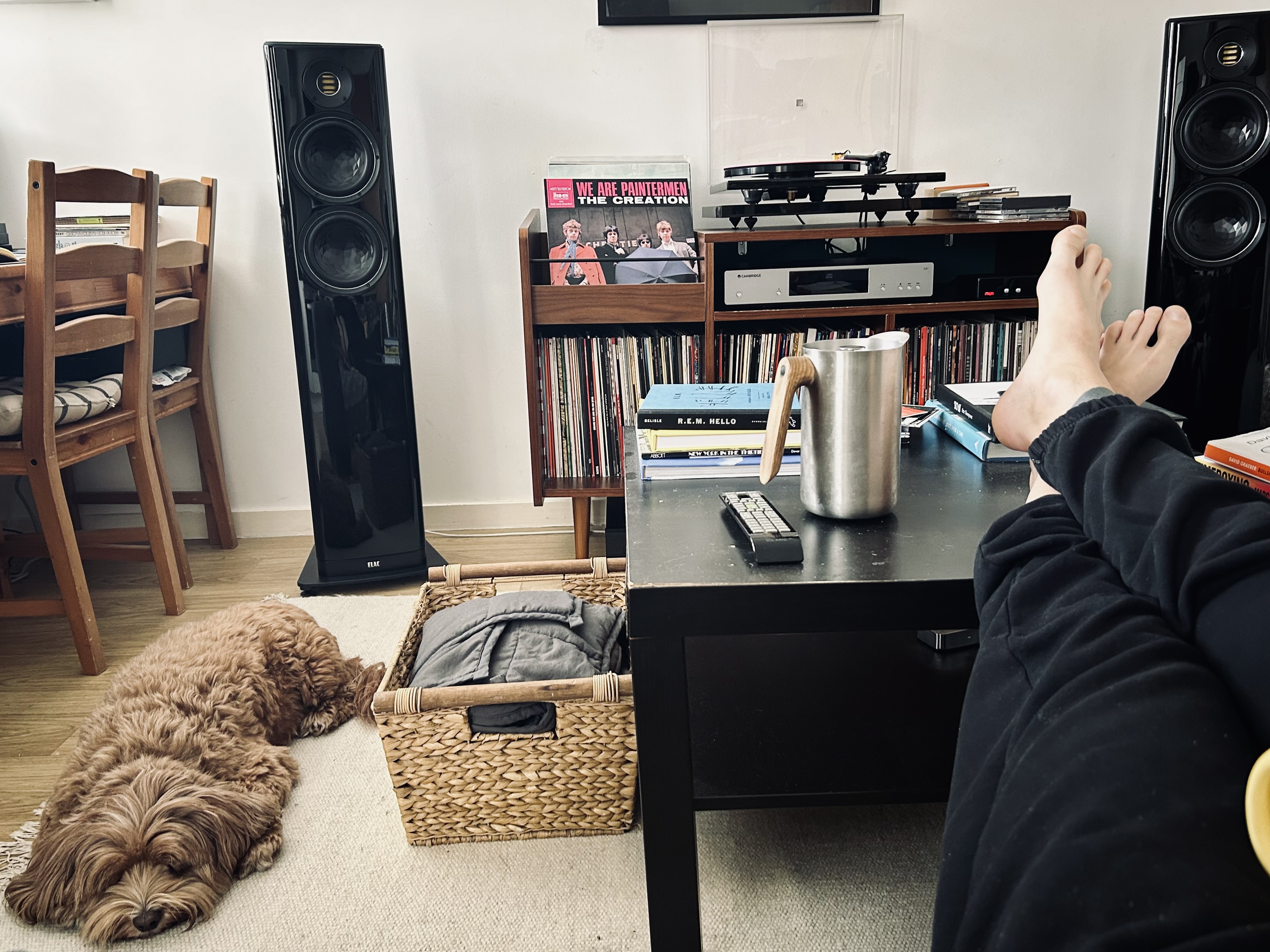

Well, gonna do a scientific test @Stuart83 🙂
I’ve got the morning off, it’s humid & I’ve got my furry assistant to help me assess a load of music at a decent volume. Let’s see how it goes.
@abacus one of the selling points of the Rega is how muscular it is. These Elacs have 88db sensitivity, so not hard to drive.
There is no reason in the specs for overheating. Can you borrow some equipment from somewhere to see if you can isolate the problem - drive those speakers with a different amp; try different speakers with your amp?
Also look at the location of the amp. Cooling is more about airflow than ambient temperature, try getting out from under the unit where its own heat is being reflected back.
Finally, totally unconnected, but out of curiosity: I'm not familiar with your speakers, do they work well that close to the wall?
