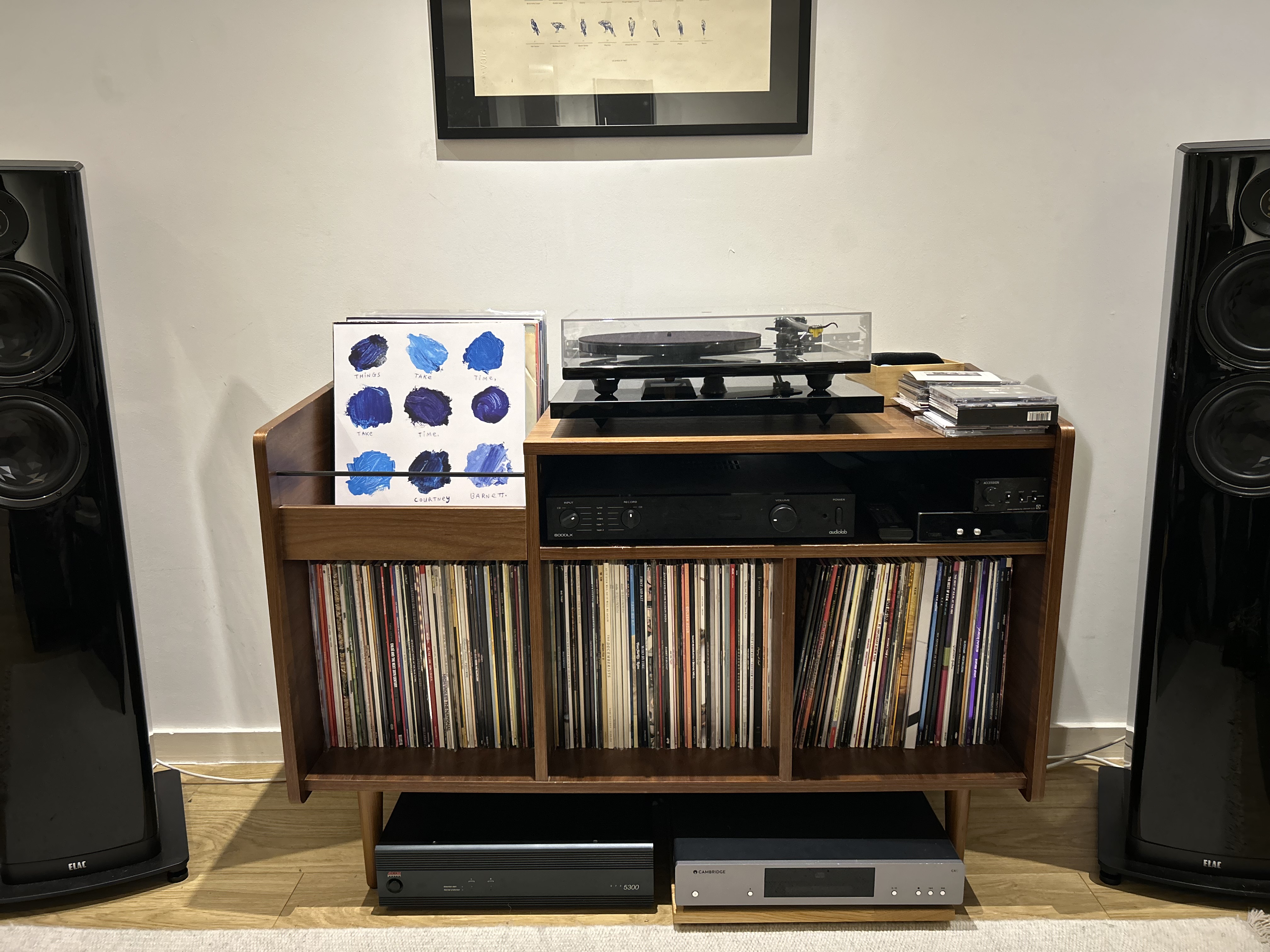

Here’s where I’ve ended up. Amp back in a sensible place which is helpful because no remote is really annoying. Modern amps definitely got that right. And, yes I’m right back to square one where I probably need a proper hifi rack 😂
It looks great. I bet it sounds fantastic

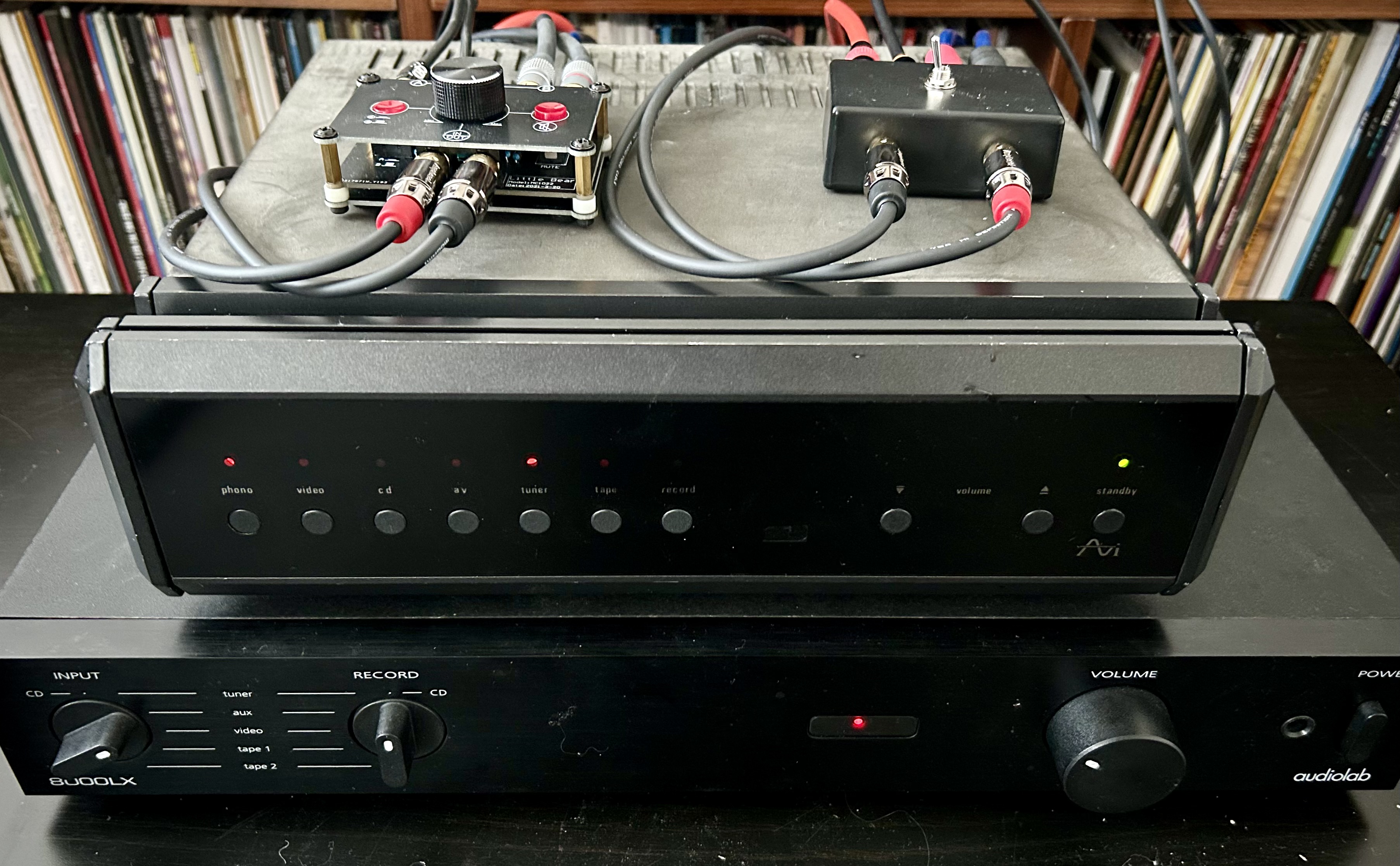

Ok, so what good is playing around if you’re not playing around?
My research led me to AVI. Apparently a brand much loved but little known. First I’d heard of them - an interesting story.
AVI units appear pretty cheap on the used market, and with all the positive reviews it seemed worth the risk to get this AVI S2000 preamp.
It’s not pretty. And the buttons are definitely of their time. I knew it was 2/3 size of a standard component, but still couldn’t help being a little disappointed when I pulled out what looked like a large car stereo from the box, and it doesn’t weigh much more either.
Excited for a chance to use my a/b switchers: WiiM to the preamps, then preamps to power amp 😃😃😃
Instantly the AVI has much punch & a little more definition than the Audiolab. Really like it, quite a surprising little thing even though I went in with high hopes. Wasn’t expecting it to better the Audiolab, but it has definitely edged it. Shame I don’t have the Rega still to compare against that.
Long story short: AVI S2000 is a keeper! With the Adcom power amp I’ve spent £390 & it’s pretty much on a par with the Elicit Mk5. Old hifi is awesome 🙌
