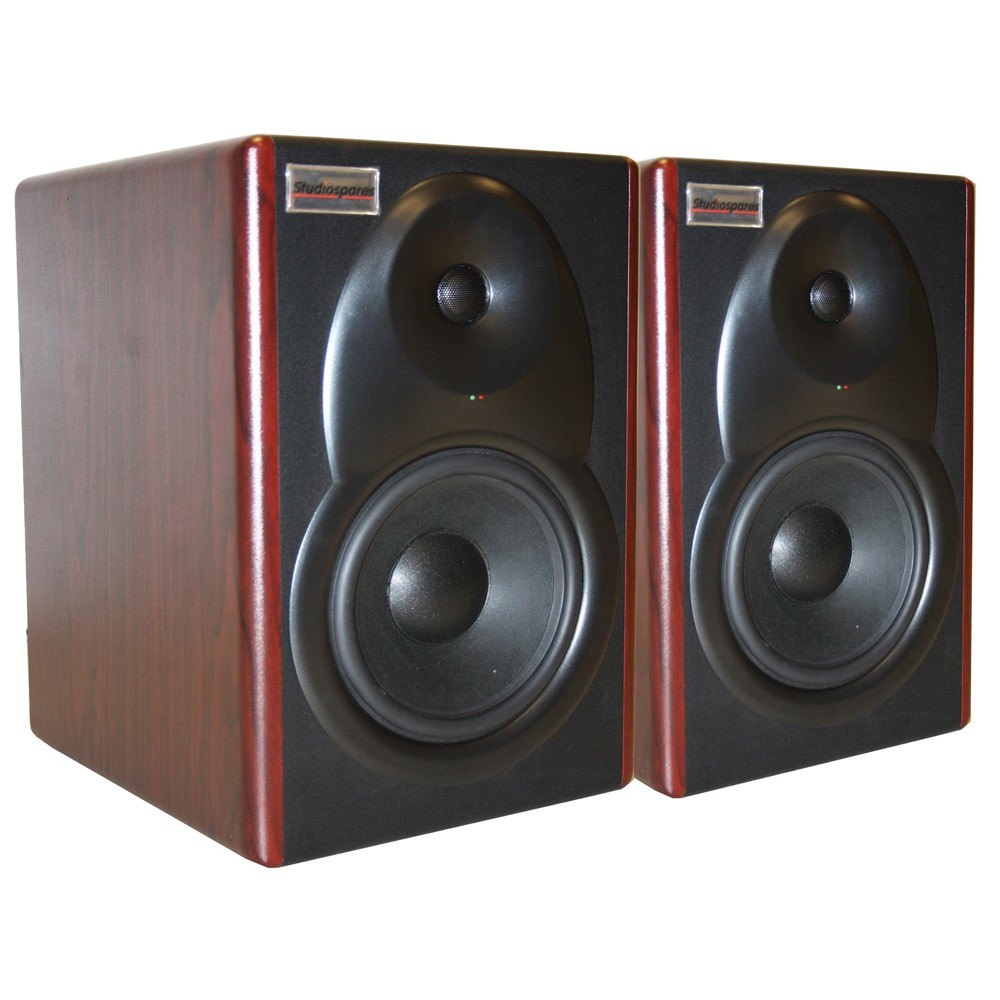

I think I would draw the line at the PA setups though, if you are on a budget, Studiospares have these for just £189pr.
