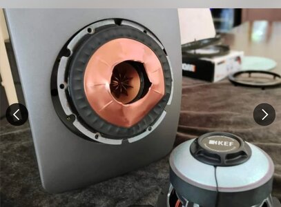

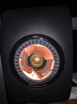

I appreciate your perspective. I spent most of the night looking through various American sites and gathering information. These images, comprehend the appearance of a blown LS50 driver. The comparison is vastly different from my driver, which I'm putting down to a durability issue. The amplifier is not the culprit in this case.
  • Screenshot_2023-09-29-10-54-27-980_com.google.android.googlequicksearchbox-edit.jpg
  • Screenshot_2023-09-29-10-50-21-375_com.google.android.googlequicksearchbox-edit.jpg
podknocker
Wowzer!
I dread to think how loud these were pushed to cause that level of destruction.
When you hear clipping, or distortion, you turn the volume down.
Most of these issues are obvious signs of abuse and many people should know better.
Your KEFs are intact with just a bit of a crease. It's still a mystery to me.

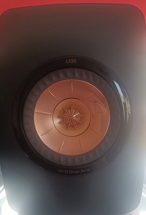

I recently discovered that I purchased them on 20 March 2019, not 2017 as I had previously thought. I have included a picture of the driver in natural daylight. @Gray - The speakers are located on the opposite side of the room from the radiator. My heating system is a kerosene oil tank located outside which heats the radiator. It is on for only one hour in the morning and one hour in the evening during the cold days. Due to the increase in oil prices in Europe.
