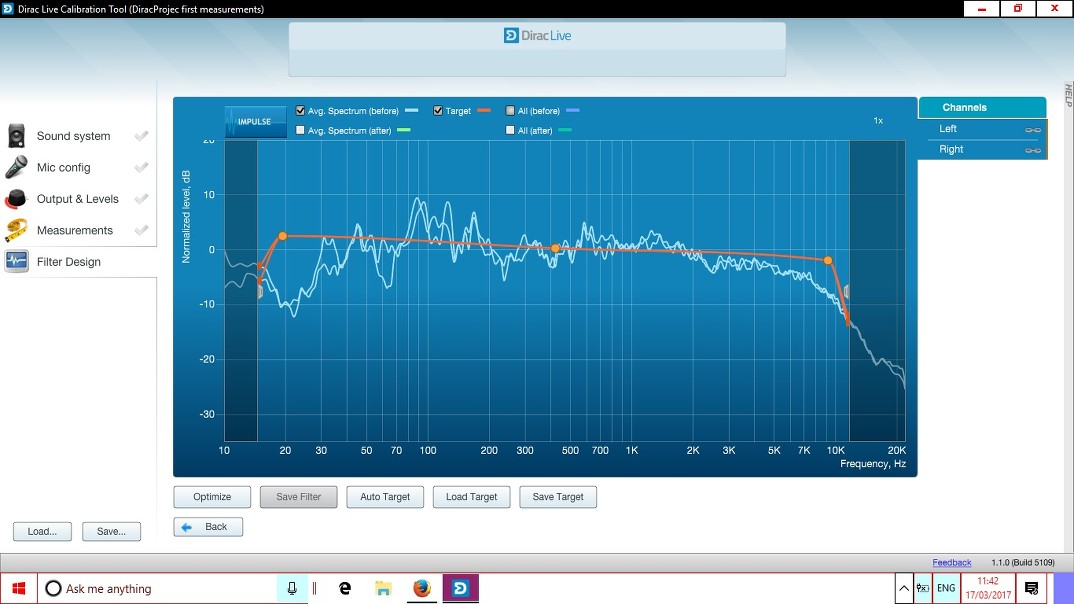

This is my very first attemot at getting a measurement. I know my room really is far from ideal so I'm expecting horror story levels of feedback... 🙂 but that's the point isn't it, to try to improve things.
This was taken with one sub only. The other I can't use in this temporary home, just no room. I'm moving later in the year so I'm hoping it will see some action then.
Anyway, here it is, any feedback greatly appreciated thanks.
Hi lion, just looking at the side line, if that's OK?
I see a target curve, and two average spectrum curves. Is it the result of two measurement sets, superimposed one over the other? What are we looking at?
I can tell you now you are going to see a massive improvement after dirac.
3 things of note there
1. decent freq reponse from 50hz to 2khz. However you have very aggressive tailing off of your treble - I get that as well.
I am guessing that means the dispersion of the AVI is not that great and your sitting off axis of the tweeter hence the rapid fall off. If you toe the speakers in more I bet the treble would go up more where you want it.
2.your bass extension isnt great - the bass is falling off rapidly from 50hz - which is your using sealed BK subs I had the same thing in my room - they are out of puff when it comes to deep bass and dont really do it. Having 2 might help that but its unlikely to do a lot there.
3. You dont want to use the dirac curve it gives you because look at what its going to try and do to your sub at 20hz.
You need to adjust that moire inline with what your subs actually doing - so put the dot on 30hz where it actually measures.
4. I dont know how much your sub is turned up but It might be an idea to turn sub up more and maybe measure again - I think you need more low end output because your bass is lean from 100hz down
5. - can you show the before and after impulse response please - Thanks
Hi DocG
I haven't a clue at the moment. 9 sweeps were completed, each time moving the mic into positions demanded by the Dirac program. That was the graph that Dirac provided to me straight after. I'm about the post an image of an proposed auomatically generated target curve I think... I really am clueless at the moment, sorry.
i should have messed around with it a little befor posting again but felt as the original point of the thread was that I couldn't even get the software working properly, I felt it was only right i shared this minor success, no matter how tragic. ;-)
Dirac makes it look so beautiful after its done its thing - that is just an average not the full story but it doesnt matter - it works
Its also hasnt overdone the deep bass - however see how it sounds like that - see if the sub sounds like its struggling with the deep bass notes
But on first glance much of what you state seems to apply. I thought about toes in after getting the Oppo, before I felt i didn't need it . Please forgive me for not replying further now as I'm going to log off for a while, then sit down and read your observations over a well deserved cuppa. Seriosuly thank you for taking the time to write such a detailed reply. probably much is way over my head but I'm trying to learn, fast.

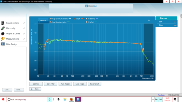

thanks.
i've just saved that 'curve' and loaded it. As long as I play from PC direct to Oppo by usb/dac I am assuming I will hear all alterations?
Just played Deep Durple - Fire ball Flac 96kHz and sounds rather good but is that my expectation bias, perhaps the changes havent been applied...
Dirac looks like its done a great job - however I am of the thinking the least it has to do the better.
You also need to check the overall level of dirac - it will be set to -8.0db
Open up the Dirac Audio Processor - there is an arrow to the left of the boxs where you select your filter set.
That opens up some other opitions - you want to raise the level until you get clipping then back it off until there is no or minimal clipping.
Well done and dont panic if you need the volume knob a lit higher than usual that is to be expected.
Feedback on the performance please for others - I am already a convert
feel like I'm seriously multi-tasking, coffee in hand, foobar pumping out some NWA, neighbour banging on floor from ceiling below. The sub had to check it's doing it's stuff, boy was it!! Really intergrated better.
Found the second part of the software and loaded the generated filter, that's all working well,
Listen I don't want to sing this things praises overly at the moment, but if this isn't any kind of expectation bias, this is for real. Already without any physical changes to the system, re positioning etc, which I had planned on doing anyway for the sake of experimentation, my system (even with non- excellent) speakers sounds great.
I think I'm already sold and want this loaded onto my minidsp2x4hd. Now I'm confused as to where to locate that in the chain but that's another matter.
Right,now I just want to play music!! ;-)
