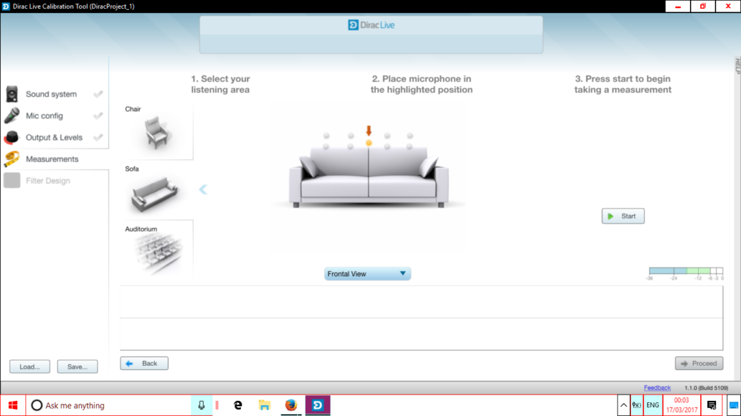

Setting the levels to go from blue into the green. Both speakers playing the test tone indenpendently of course. Then I get the blue proceed to go to measurement screen. Set the mic up in sweetspot (first position) grey proceed button. Same each time.

At the bottom pf the screen these are my options from left screen to right...Load, save, back and proceed. In the notes that appear right of screen they mention a start option, that is not visible on my screen.
Re the silent edit, you're tying me up in knots with that one... totally lost. ;-)
Thanks again.
See the start button - thats what you press -

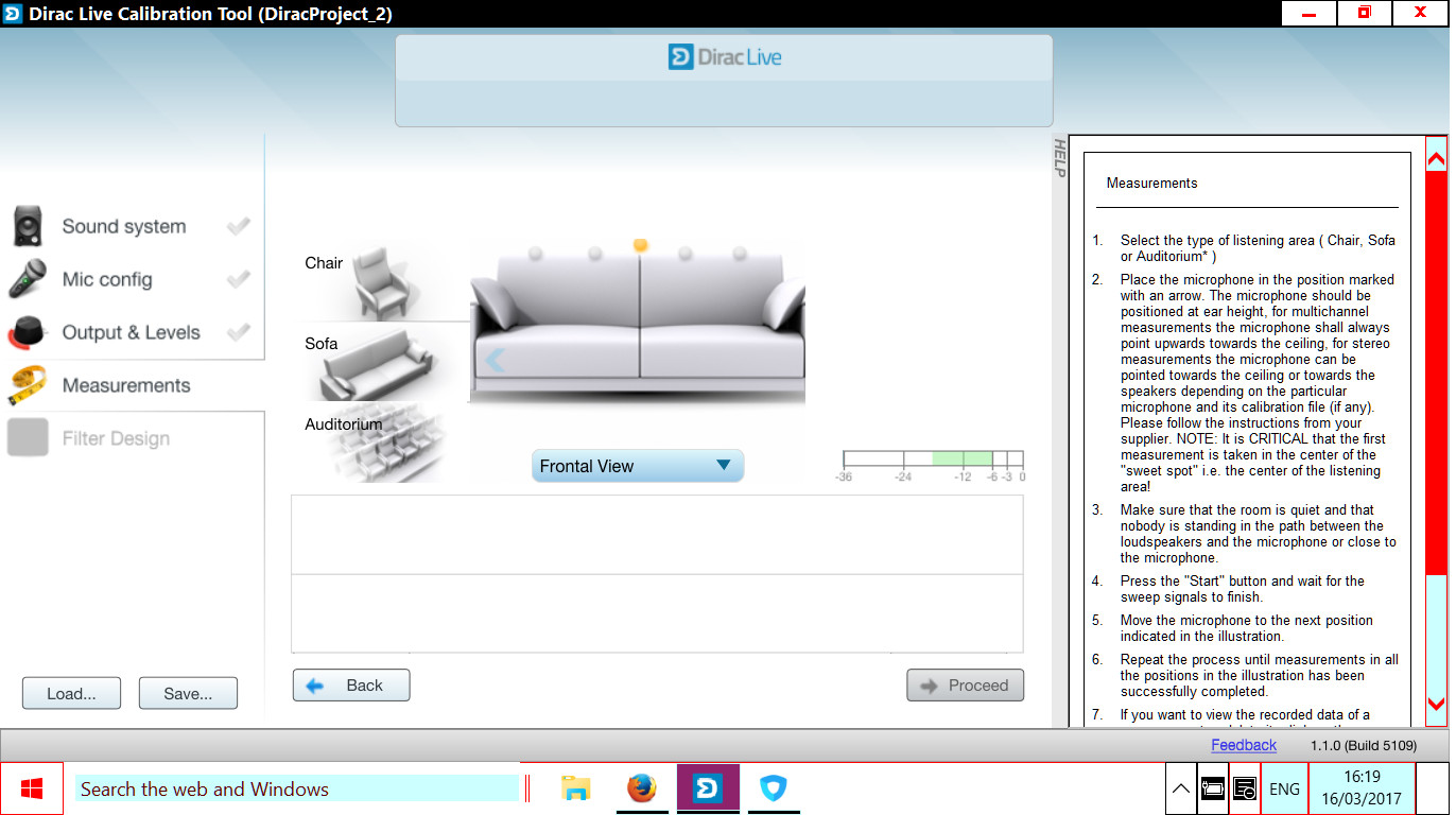

I think the start button will be behind the help section on the right hand side.
You can only proceed after you have taken so many measurements - close the help and I bet the start button will be there
Back out from the cupboard it comes and I'll give it a pop. Still got half an hour before the toys must go way. Ta again.
That is where it should be thats odd.
Now you have a photo email dirac support showing the photo and they can hopefully help you.

Just a though since the button is greyed out. The ticks are also grey... Shouldn't they suppose to be green? Maybe you've skipped some steps hence you can't do measurements.
Yes their customer support have been back to me a number of times already. They seem to think (like you suggested) it could be a Windows related issue, namely screen resolution and font size. I'm currently down loading the latest update, taking an age but will see how it works out tomorrow. I really want it to work out, despite the problems I like the look of the software.
Insider... those ticks were green as the sctions were checked and completed previously, thus allowing me to progress to the next stage. Up to the point at which I'm now stuck there were only progress buttons and no start buttons. So as the start button was playing hide and seek I assumed progress was the way to go. I hope the update sorts things and I can have a play with this tomorrow afternoon.

of windows updates and eventually figuring out that the display was set at 125%, success! I'm useless at anything to do with computers and my daughter had let the updates slip. Some drivers were also updated then just before midnight, a START button. Can't wait to try it out. Thanls to Ellisdj and for Insider for virtually keeping me company in this struggle. Must also say the technical support from Dirac was second to none, well recommended. I'm sure once the trial is over I'll be purchasing. Well I get to play tomorrow!
