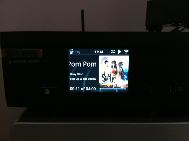

Ok 24 hrs review:

Built
The unit is similar to the other M series. Although putting it side by side with M1 DAC, it looks slightly higher. I love the black granite finishing. Adds a sense of class.
Its a compact unit which weighs next to nothing. Very light but sturdily built.
The screen, to me is just the right size where contents can be easily read through.
The power button is of soft touch nature. Press it and the unit will be on standby mode for 10 seconds before it boots up.
Remote: Aaaaahhh this is a bit sad. The remote, although feature packed, feels a bit el cheapo. It reminds me to one of my old VCD player 15 years back that cost 20 quid. The unit can only be operated by remote control, so dont loose it.

Connectivity - Superb. I tested the whole day with wireless connectivity. My wifi route is downstairs and this unit is in my hifi room upstairs. It can detect the signal easily. Only 2 bars on the signal icon though. Keying in my wifi password was easy. The remote comes with mobile phone-like keys. Repetitive pressing on button to select the alphabet.number you want. I only had to set it up once and voila, within 5 seconds, its fully connected to my network.
First, I scrolled to media server on the CLiC and found my NAS with over 8000 digital files. All grouped to usual Tracks, Artist, Albums, Genres etc. Next I booted up my laptop, and again within a few seconds after the laptop has been booted up, the CLiC detected it.
For my iMac however, it could not as I have not installed a Twonky Media.
Next I tried the connectivity for internet radio. It automatic goes to Malaysia directory and found 6 stations. Tested all of them within a span of 30 mins and no signal dropout at all. However, these are not the most famous local radio stations. So tried with London and US radio stations. Again, no issues of drop out signals at all.
How about connectivity to iPod/iPhone?
So I took one of my Apple docks and connected the Apple provided USB/iPod cable to the CLiC. The USB/iPod connection is not interchangable with front USB connection.
But, it could not detect my iPhone 4 or iPhone 3GS. A note came out on my iPhone saying 'Could not operate 2 connections' or something like that. Ahhhhh this is when I started to open up the manual hehehehe.
Sooooo, I cannot connect it to a dock. Thats what went wrong. It can only be connected directly to the iPhone/iPod. reason being, the dock also have its own remote. Thats why the note came out cannot operate 2 connections.
Once I connected the iPhone directly to CLiC, it detected all my the songs on it and also the playlist within seconds. Its just then a matter of choosing the music you want using the remote.
On the screen, the song, album and artist is shown together with and also any picture/art cover attached to the song. It can be easily readable from about 3 to 4 feet away.
