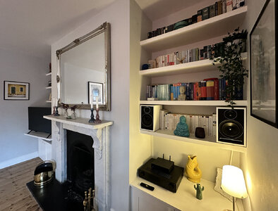

a shot of my set up for context. not ideal in terms of speaker placement. the shelves are wooden and pretty solid, but hollow. ideally i'd have a speaker either side of the fireplace, but cabling is an issue.

No ability to "get creative" with some conduit in order to put floorstanders either side of the fireplace? i.e. through the cupboard below the equipment? But I feel your pain - I hate the sight of cables.
if i was staying here, i think the only option would be cables under the floorboards and installing some solid shelves either side of the fireplace. i reckon my next place will have a similar layout, but at least i can start from scratch!
