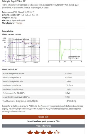

No matter how loud i try to play, my tius ez don't make my shelf in my kitchen Shake, Rattle and Roll, they don't go depper then 57 hz at -3 db , -11-12db at 40hz so 40-45hz -3d shouldn't be difficult to acheive
