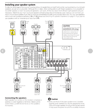

Sure have, although there is one difference I have discovered and that is with the Pioneer VSX-LX70 amp with stereo I can’t use it and the subwoofer together with it. I am using standard on the remote to get it to work, whereas I am using stereo on the other two amps. The LX70 will just not work with stereo and the subwoofer together I have tried everything to get it to work and nothing will work.
So the comparison is now flawed for the LX70 amp, which might be why it’s was so aggressive.

Really weird that. If it has other alternative options to connect your SW, maybe you can try that, see if it makes a difference?
I am ok just listening on standard settings I get the sub working then. It doesn’t sound perfect but it’s ok, otherwise I am back to Stereo and no sub sound. Cheers guys!
In stereo mode, have you checked that the subwoofer is enabled in the settings menu, as well as setting the front speakers to small as mentioned in a previous post above.

From the manual:
Page 30
Listening in stereo
When you select STEREO, you will hear the source through just the front left and right speakers (and possibly your subwoofer depending on your speaker settings).
Page 50
Front – Select LARGE if your front speakers reproduce bass frequencies effectively, or if you didn’t connect a subwoofer. Select SMALL to send
the bass frequencies to the subwoofer.
Page 51
Subwoofer
LFE signals and bass frequencies of
channels set to SMALL are output from the subwoofer when YES is selected. Choose the PLUS setting if you want the subwoofer to output bass sound continuously or you want deeper bass (the bass frequencies that would normally come out the front and center speakers are also routed to the subwoofer)
Reactions: Holt
From the manual:
Page 30
Listening in stereo
Page 50
Page 51
Subwoofer
The plus setting is interesting, I will have to try that. Thanks for the info.
