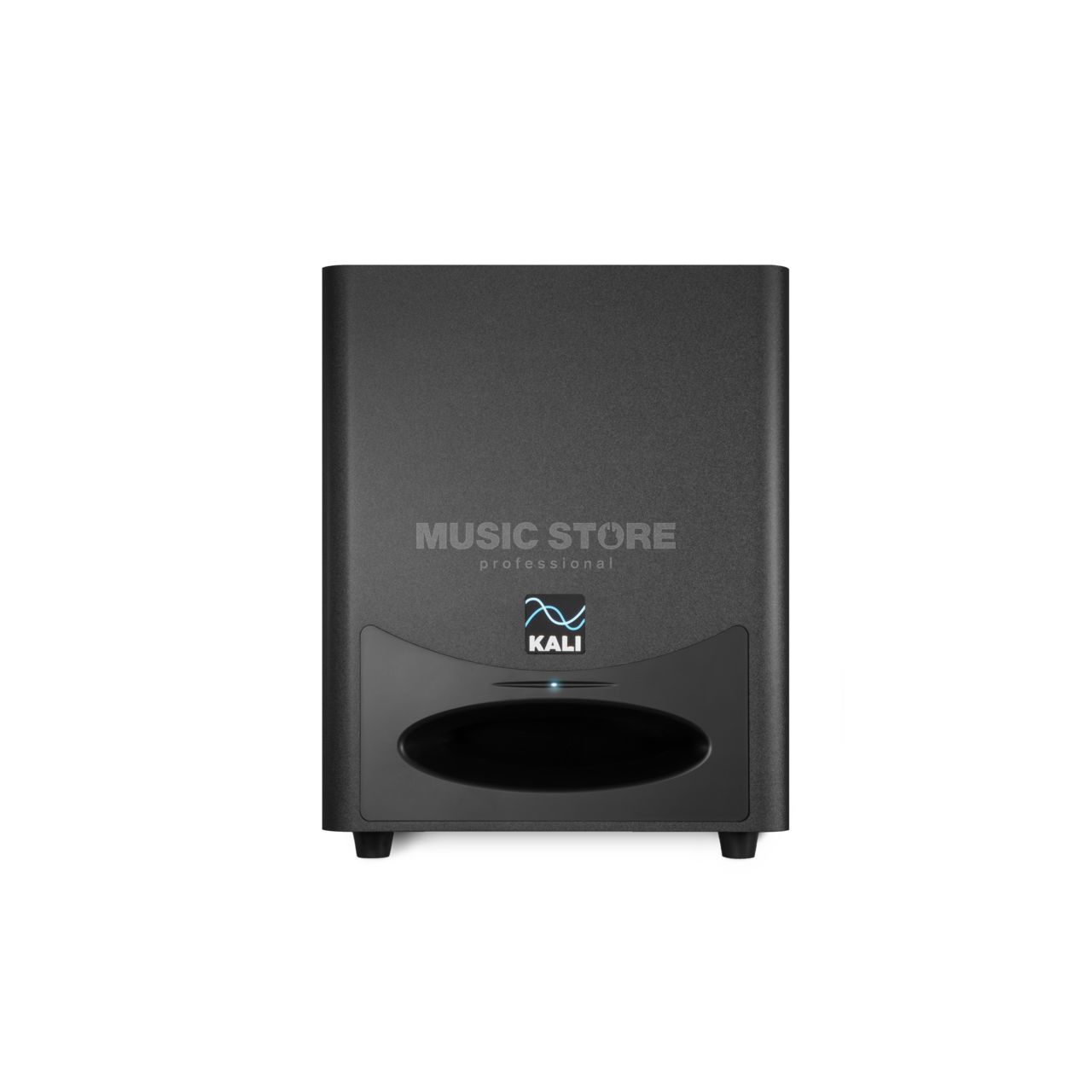

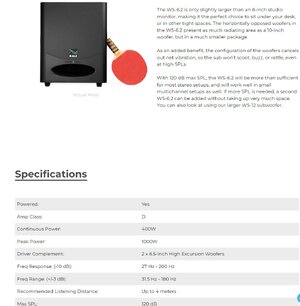

Kali Audio WS-6.2

For £300 new you can't get that kind of bass and not 25hz at -3db
Kali sub rated at 120db it could do 110db at a flatter frequency responce then 120db
