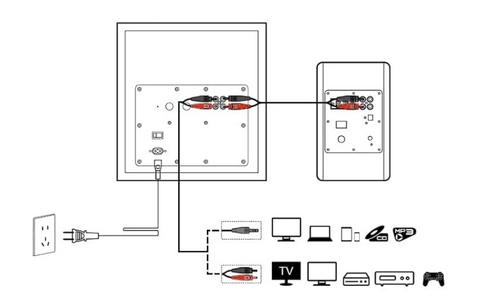

So, If i get this Edifier T5 sub. I would be needing 2 RCA cables and the connection would be like this:
Zen DAC RCA out (1st RCA cable) -> Edifier T5 sub RCA IN (1st RCA cable) -> Edifier T5 sub RCA Out (2nd RCA cable) -> Speakers RCA IN (2nd RCA cable) as shown in the attached file.
And this should work and requires no splitters and whatsoever? and would also feed both my sub and speakers simultaneously?
Please ignore my dumb questions 🙂

Thanks folks for all your answers.
That's how to do it 👍
Both your main speakers and the sub get a full- frequency signal from your Zen DAC.
The sub uses its own (internal) low pass filter to take what it needs from its line inputs but passes all frequencies from its line outputs to your main speakers.
Once the relative levels and crossover frequency are set to your taste, the overall volume level will be controlled by the Zen's variable output.
