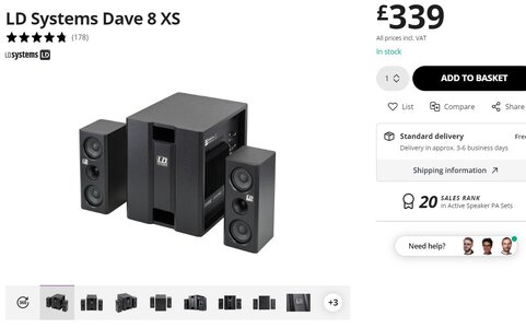

LD Systems Dave 8 XS it might only say 45hz but if you heard the lyngdorf fr2's going down there rated 45 hz, you won't think about bass extention only down to 45hz, the system is rated to 117db
