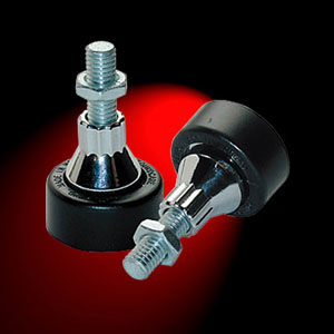

Previously I have always used my speaker floor spikes because I have had a carpeted room, however, I have just invested in a new solid wooden floor and the spikes are scratching the surface.
My question is, is it better to use the spikes on a wooden floor, or are they purely for carpets? - I notice that if I withdraw the spikes completely that the stands wobble a bit (they are not level)

Use coins under the spikes or for the professional look Atacama make 'sike shoes' for this very purpose. Available from Superfi for £13 a set of 4.

I faced this problem myself and wasn't happy with using coins thinking one slip and the speaker could crash off onto the floor! I eventually found some 1/2" felt pads made by Surface Gard in Robert Dyas - they've got sticky backs so stick to the floor and then the spikes can press down into the felt like it would on carpet - problem solved!
