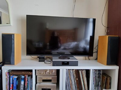

I only ask as I have purchased a C600 and have had no trouble at all with the bass.
Symples
I am very happy with the amp.
I like the way it interacts with my network. It's great to have all these apps pre-installed and those that aren't, there is always Chromecast.
Sound wise I am very happy. I always thought that I would need more power (hence the Klipsch. Greater sensitivity. More on that later.
As the Missions are over 20 years old. I thought that I would try something new.
The Klipsch fitted the bill.
Down to Richer (Croydon) for a booked in demo.
Source: Cambridge Audio CXN
Amp: Cambridge Audio AX35 (About the same power as the C600)
First up the Klipsch.
They sounded grea. Yes I would like a little more bass, but what do you expect from small speakers. Great with jazz and vocals.
Next up, the Missions.
The first thing I noticed is how inefficient they sounded compared to the Klipsch.
Up goes the volume and here we go.
Wow.. I have never heard my Missions sounding so good.
Why? Simple really. Instead of being a couple of feet apart. That were mounted on stands and a decent feet apart.
Compared to the Klipsch. They sounded less bassy. But besides that. There were practically little difference.
I decided to keep my Missions and will see about placement in the bedroom.
If I didn't have the Missions I would definitely have purchased the Klipsch.
Another point I realised was that I most certainly didn't need load of power. The Missions can go loud enough...... not party loud.

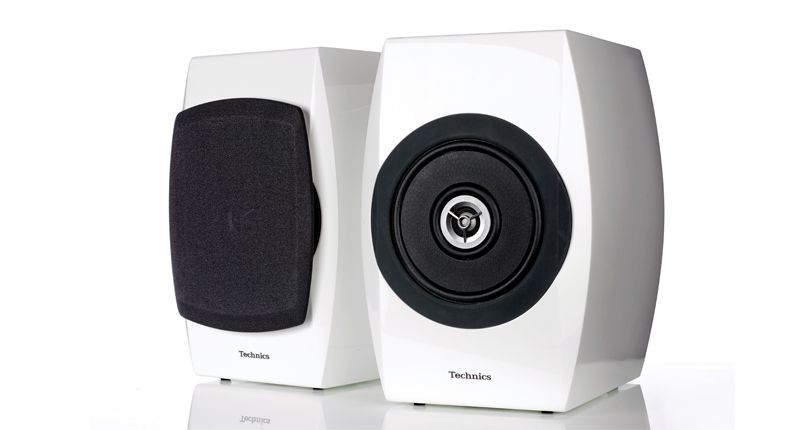

I got the Technics SB-C600 speakers that are designed for the system. I was looking at some KEFs, but these had excellent reviews and are a nice size.
