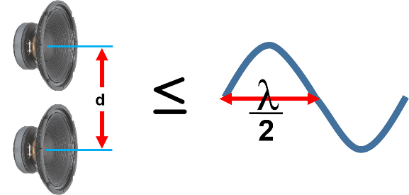

When a second powered sub is added, of which all subs mentioned in here so far have been, both cone area and power is doubled for all frequencies falling under quarter wave theory in respect to distance between subs. If you have three of them, that's an extra 9.5dB compared to one. Is the room going to have its say? Yes, in both directions (modes, room gain, boundary gain, absorption coefficients), but doubling up on identical subs within 1/4 wave will always contribute +6dB.

You would be half right if we were only talking about doubling either cone area or system power, but his is a discussion on powered subwoofers. When you double them, you are doubling both cone area for +3dB, and doubling system power for +3dB, giving a +6dB when following quarter wave principles. It is independent of what the room is doing (room gain, boundary gain, absorption), which is a null point anyway because what the room is doing gets applied to a single sub situation anyway. Simple fact is, the doubling powered subwoofers gives you +6dB. Unless you know something that the engineers I have spent time talking to when I was working in the hifi industry don't.
QSC have a wonderful blog written by Barry Ferrell (a 20+ year veteran in theatre equipment and design. I have designed over 300 home cinemas myself when I was in the industry, but this guy has forgotten and remembered magnitudes more than I know) showing what happens when you add a driver but keep the system power the same, when you simply double system power, and when you do both.

Not arguing with that, I am talking of 2 of the same subwoofers will only give +3db due to increased come area, amplification remains the same.
