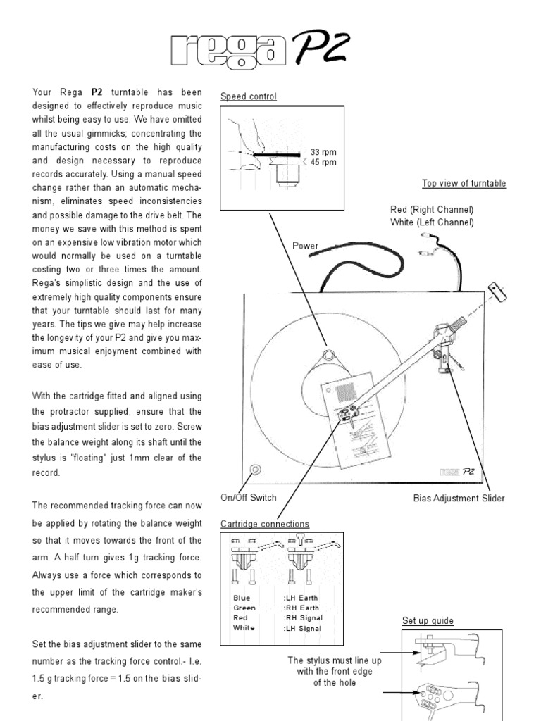

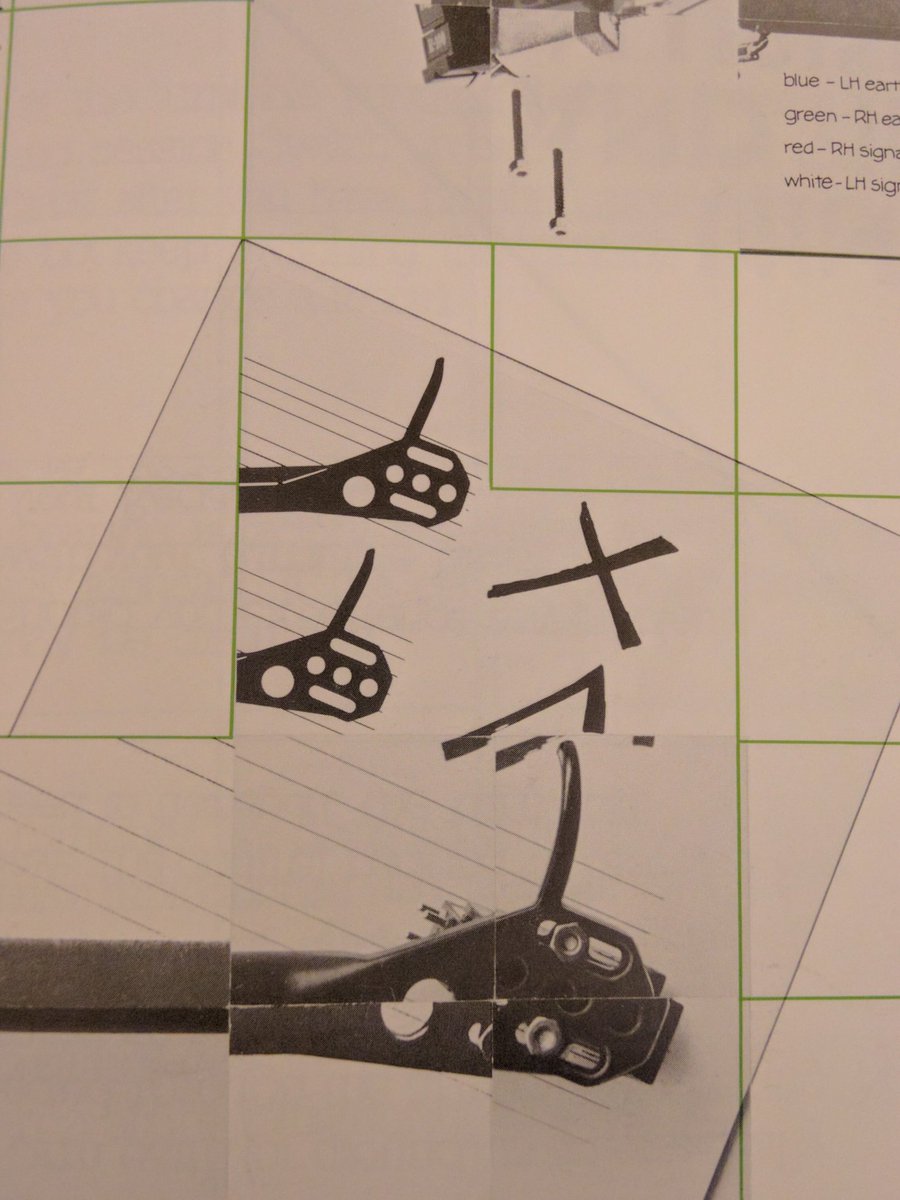

Back in the day (in my case November 1983 and my first RB300 Planar 3) Rega provided instructions in the form of an A3 sized poster (excerpts below) along with a card protractor ...
My last Rega TT (a 2008 vintage P2) came with less 'artistic' instructions ...
1491986068
Your P1 was designed to be used by people who'd never want anything (literally) 'outside the box' and thus has the appropriate level of instructions.
