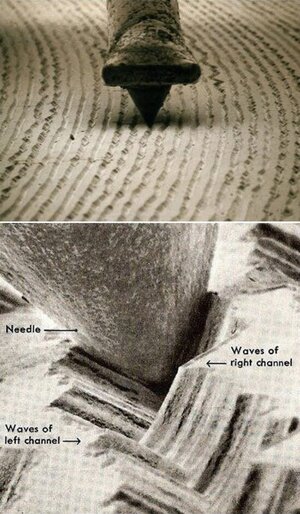

Record player measures a tiny vibration cut into a Groove
1/ Must rotate @ constant speed 33 or 45rpm
2/ Hold/Position a tonearm above the record surface & support a cartridge
3/ Cartridge will measure the groove & produce a electrical waveform
4/ Provide isolation to reduce internal & external vibration
only source of energy is internal ( motor and bearing ) external ( acoustical )
Energy must be drained out / converted to thermal energy not transmitted to and from the record cartridge interface
