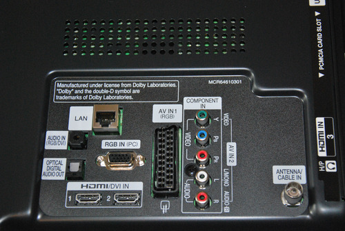

PP, can you confirm that this panel on the back of your LG is identical to the photo? ...
... most importantly the 'Optical Digital Audio Out' connection.
This appears to be the only audio output (everything else - excepting the headphone output - is inputs).
You must have that 'Optical Digital Audio Out' on your TV if you want to connect a DAC.
Just thought it worth a double-check before you spend more money.
Apart from the headphone socket on the right.
I think PP tried that before. It worked but he didn't like the sound quality much and didn't like having to unplug the cable every time he needed to return sound back to the TV speakers.

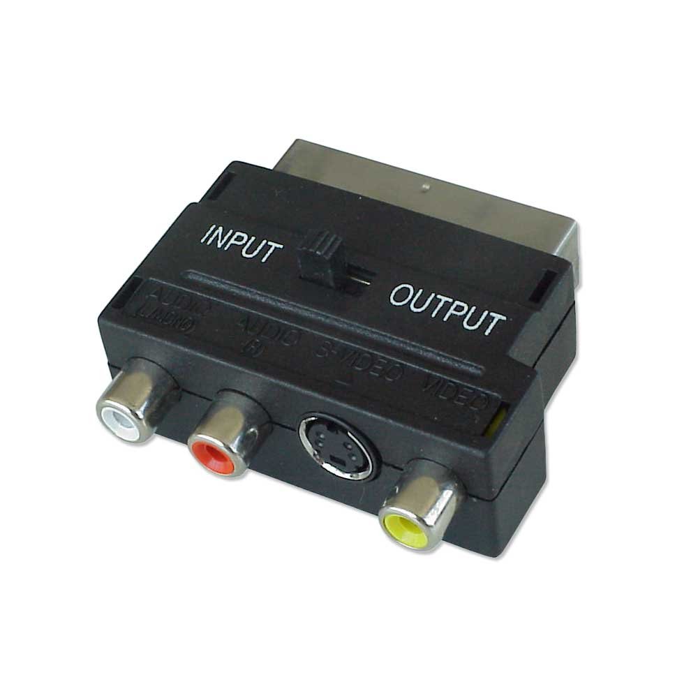

Possibly the scart too.
Worth spending a couple of quid on one of these to find out
Not with the SCART in the photo (AV input) unless there is another SCART for output somewhere else on the TV.
From the same manufacturer, this lttle box might be better ...
clicky

SCART is bi-directional, and TVs often output audio/video. Its difficult to tell from the photo (and the crappy site no longer allows zooming on mobile) but the SCART symbol looks to me to have the double headed arrow indicating its a bi-directional SCART socket, rather than just an input (would have a single headed arrow pointing into the box)
Ok I understand but I am trying to keep this to certainties rather than 'worth having a try'. I don't think PP is at the point where he wants to take any more chances.
Yes, that's the one.
