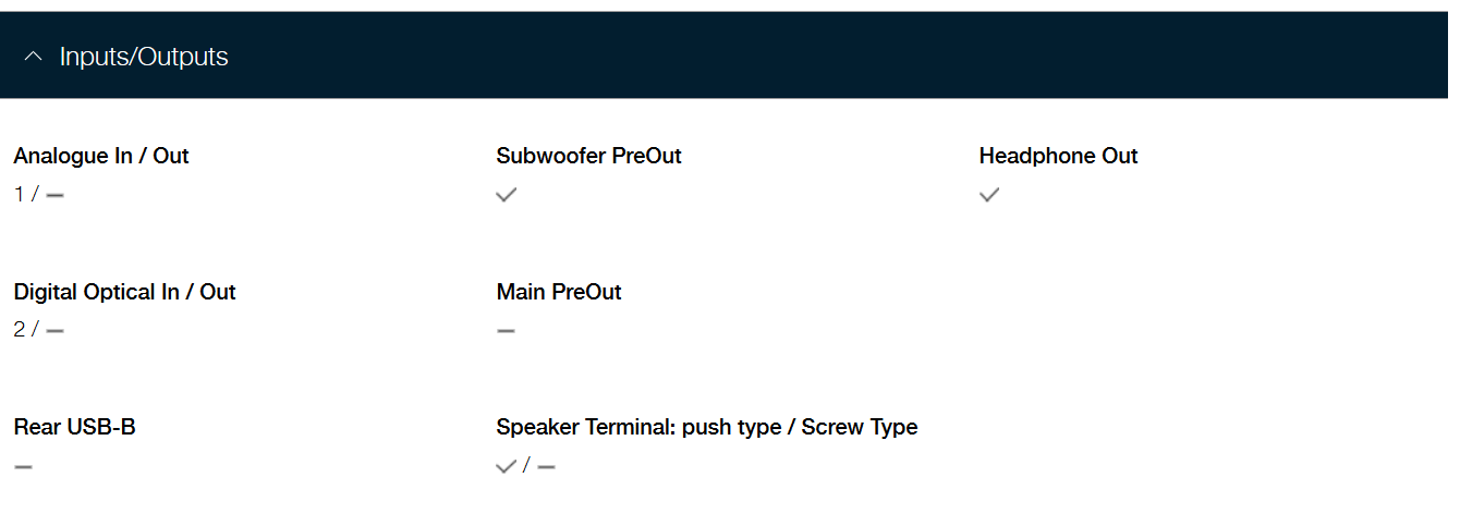

Actually I've just got round to looking at the back of the amp (it's actually a mini hifi) and it doen't look as though you can connect to it using anything other than bare wire. It's a Denon CEOL N11.
Here's a list of the inputs/ outputs
Pretty sure if you unscrew those terminals there will be a hole in the post that will accept bare wire.
