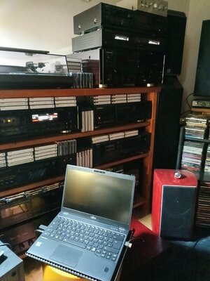

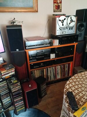

this were my two last systems i assembled in a dinning room in my family house because my mother lives there and she´s old but i staying there at night i had to have music but a litle room only ,having what i call a colection i opened some boxes and found this ,some speakers are not even conected but in my two persons couch both systems sound good to me, with i have to admit , badly positioned speakers, B&W, Mission, JBL and Pioneer, others aren´t conected, the laptop is there because i have spotify and at home i have a streamer and if you notice a big cable from the system on the bottom is to connect to it ,a independent system, to the laptop. there is the left one and the right one, in the midle is my new smart tv ,a LG one but not seen
