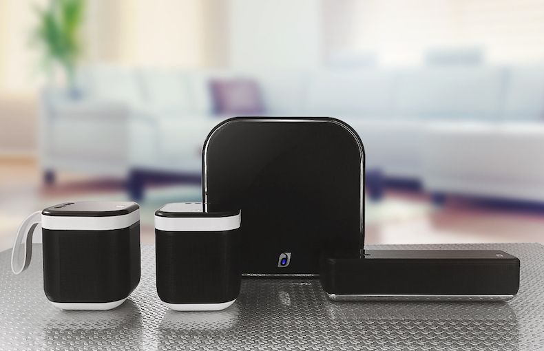

bigboss
Moderator
From what I understand, you need a no fuss wireless projector system with Atmos.
Check this out:

Thank you for suggesting this but I am not too sure how this is actually solving the problem.
Please could you explain a bit more how this system would play Netflix movies in Atmos and then connect to projector.
newbee73131
Jun 16, 2020
16
Sorry I've replied too quick without actually getting into the details. I see now from the Damson website that this actually works like AV receiver and wireless speaker as well. Very interesting piece of information.
I would like to hear more from someone who actually owns this item and hear from them if possible.
Thank you so much again for recommending this product.

Thank you. I see that it would work with the TV with ARC but would this work with a projector?
DAMSON (HDMI ARC) => TV with ARC.
TV will have SKY Q to receive the video.
Is this better than Samsung Q90R ?
bigboss
Moderator
Yes, if it works with TV, it will work with projector. Of course, if you're planning to use Netflix app on the projector, I'm not sure about Atmos. But you can connect a source (like Roku stick etc.) to the Damson for Netflix.

Is Damson S series better than Samsung HW-Q90R soundbar?
bigboss
Moderator
The Damson sure will give a better surround sound effect. The bass in Damson is weak as per the review, not sure how good will it be in a soundbar, although a separate subwoofer suggests it may be better.
You can also go for a cheap AV receiver and you get wireless modules to make speakers wireless. So you can have a proper AV system without the wires.

I was slighly worried that the surround speakers were actually battery powered in Damson. This is the reason I wanted to go with Samsung.
I would like to go for a reliable brand with good build quality as I dont want to upgrade these systems for several years.
