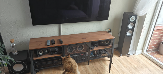

Hi, I have an AV setup that's around 8 years old: Monitor Audio Silver Series 6G (L&R 300s, a c350 and 2 Silver FX's), paired with a BKE P12-300SB-PR Sub Woofer, a Denon AVC-X3800H, and a 55" LG OLED TV.

How big is the room overall?
If you decide to lower the ceiling it seems an ideal opportunity to install ceiling speakers for the height channels - MA Ceiling Speakers.
If you don’t decide to lower the ceiling (the ceiling height should not really be an issue as the calibration will take care of that) then I would consider using dedicated speakers on the ceiling rather than the upfiring models as (personally) I find this works better. Monitor Audio Radius 90 match the silver range well.
If you are using 2 rear channels (rather then 4) then I think (but cannot be sure without checking the manual) that the receiver will support 4 height speakers. Typically, depending on the size of the room and seating, 2 would be enough.
The receiver will support up to 4 subs.
Just bear in mind that to really benefit from Atom the rear speakers should be behind the listener and at roughly the same height as the fronts. (I only mention this as users tend to place rear speakers higher when set up in a 5.1 configuration.

I have a 5.1.4 Atmos setup all Dali except the ceiling speakers which are Kef. I could not get hold of the Dali ceiling speakers i wanted at the time but it integrates well.
I would go for ceiling speakers rather than upward firing speakers if you can do it.

I have similar setup to yours, about a year ago? I purchased LG C4 65" OLED Evo 4K Smart TV and about the same time, I acquired Denon AVR-X1800H 7.2 both the TV and AV receiver were Atmos enabled and I got the itch.
You know, it has Atmos, I must get Atmos speakers but I didn't quite go the conventional route, the speakers I got weren't specialised Atmos speakers, those wedge shaped things you put on top of your speakers or hang up on a wall.
I heard on a certain forum, can't recall which one, the Polk Audio Signature Elite ES10, those little bookshelf speakers make excellent Atmos speakers. I got those, because I wasn't keen on the idea of hanging them up a wall or having them placed on top of my MA Silver floor standers.
It proved to be a good choice and work amazingly well in my setup. I have mine tucked inside the cabinet, I can hear the purest scream 🙂
