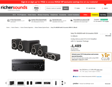

I was going through Richer Sounds for the best deals, found something that will suit your budget- see link below. The Q Acoustic speakers are more versatile than the Klipsch, though I do like my Klipsch R-50M.
Oh Ps. Make sure you join Richer Sound's VIP Membership to get the best deals, it's Free!

Thanks, good to now about the wireless - I suspected that might be the answer. I have Q Acoustics 2020i in our kitchen, I thought they were pretty average when connected to a Denon Ceol Piccolo but I just replaced that with a Wiim Ultra/Vibelink and they sound amazing now!
Any idea how the Q Accoustic centre speaker above would compare to something like a Klipcsh R-30C or Polk XT-35.
