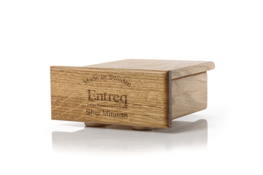

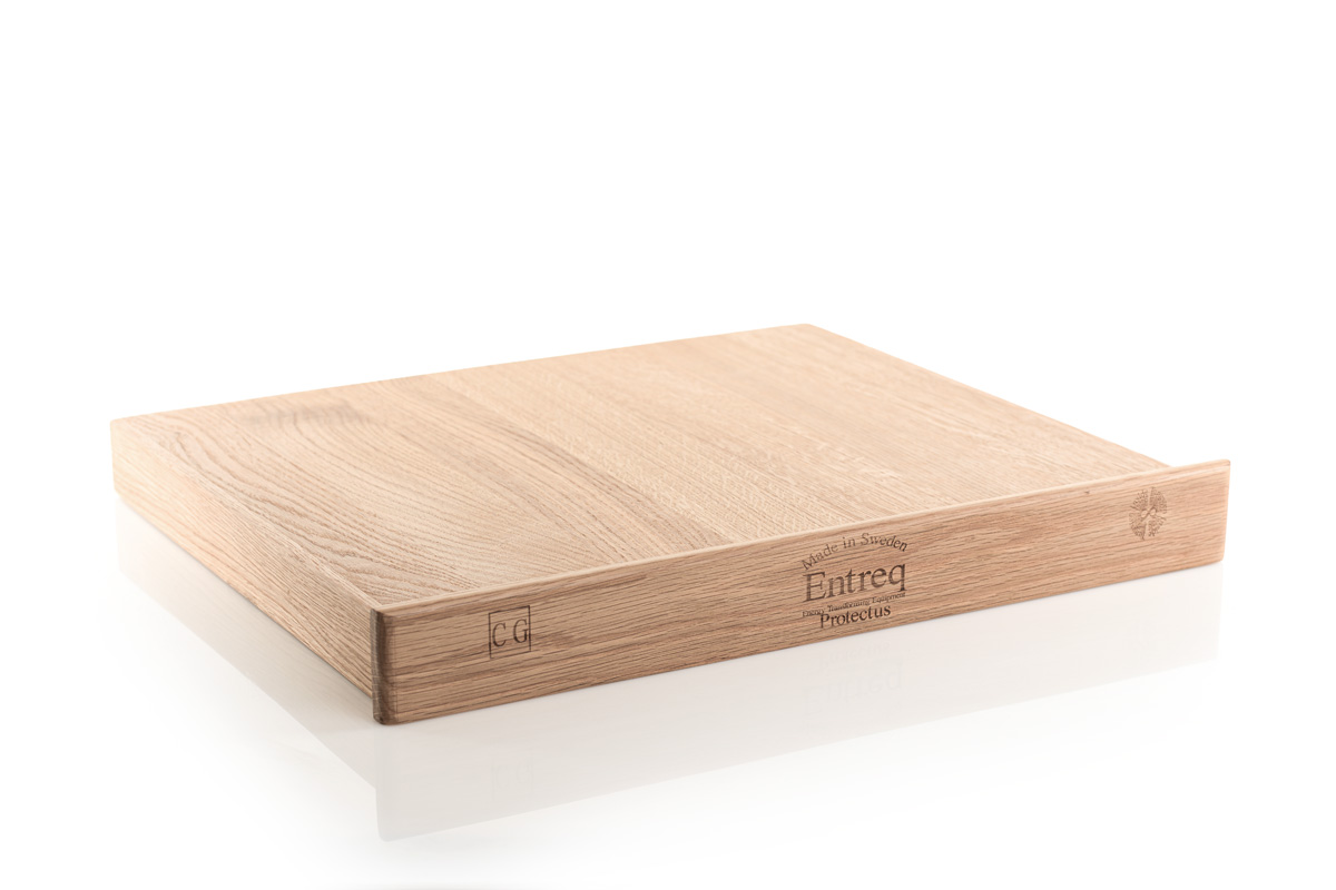

I would like to see a review of one of those boxes, one that includes a picture of the contents of the box.
Those do look interesting, though you seem to have to take them on faith as they won't say much about what's inside due to not being able to get patents. This box doesn't have any grounding connections, so I don't think it can be that.
