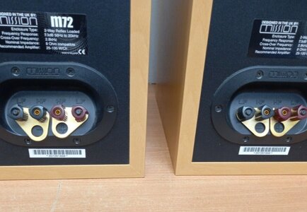

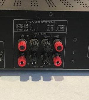

After some great advice from you guys on speakers, i now have a pair of Mission M72s. So thank you all! I now need to know how to wire them. The speakers are my actual speakers, the amp pictured isn't mine but just an image I found online as I'm not at home right now.
I have four core speaker wire, but I'm not too sure what goes where, both on the amp end and the speaker end. Sorry for asking such a novice question but, I gotta start somewhere!

If you have four core in a single jacket, I'd just twist up the conductors so you end up with effectively two conductors (making sure you have twisted together the same on each end). That doubles your cross-sectional conductor area, lowering resistance. Will it do anything? Depends on the cable length (longer cable lengths you should be using thicker gauge, which doing this effectively does), but lowering resistance isn't a negative regardless..
